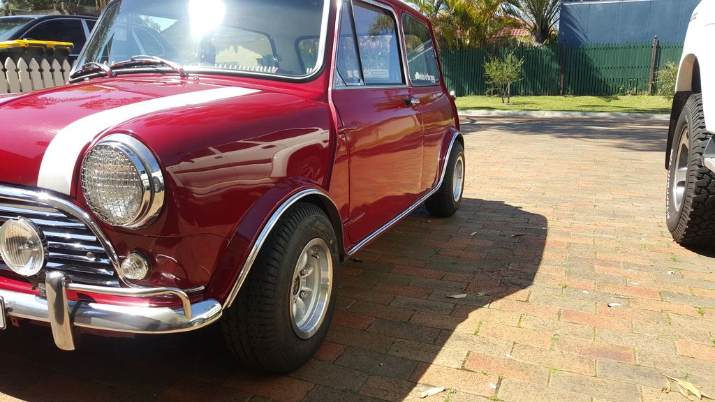

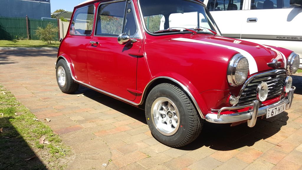

Got the new 6x10s rebalanced and fitted today, really love that phat look. Ended up with a008s.
On full lock they rub a little.
Will fit the center caps tonight
PostPosted: Sat Oct 03, 2015 4:19 pm
Looks legal still, = good. Mr Plod may leave you alone.... :)
PostPosted: Sat Oct 03, 2015 4:22 pm
Posts: 552
Location: Wollongong NSW
Yeah the tread is still under the flares. My flares are actually quite wide. I think they're fiberglass copies of the mk2s wide flares
