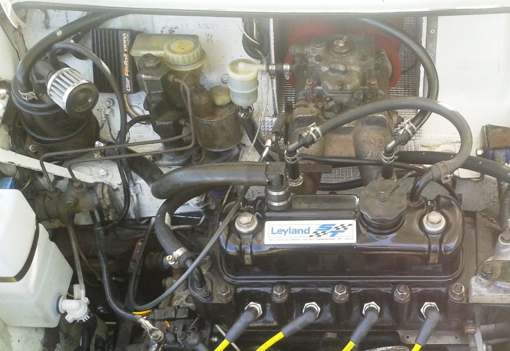

Do you have a weber box? You could run the hoses into a catch can then into the box with the weber socks. That will suck up any smells. If you don't mind the smell then just put a filter on top of the catch can. It may be worth the extra time and effort to drill and tap a thread in the manifold. What manifold do you have? Mine came with 2 threaded blanks.
I was playing around with my setup this week because I was getting oil out my dipstick whenever I went over 6500prm. The pcv valves could not cope with the blow-by alone so I have gone back to the catch can with a top filter instead of a fully sealed system. Image
