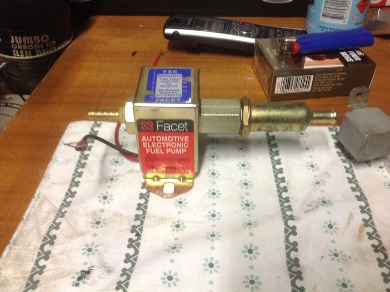

Ok...a bit off canter...relay for my fuel pump. Unsure of how to wire it in and thinking a hot wire with a 30 amp fuse to the relay and a connect into the coil as the switch. Don't want to wire in a separate switch if I can help it and aware of the safety ramifications in regards to an accident. I have removed my oil pressure switch so do I plumb one of the leads off this as a safety precaution?

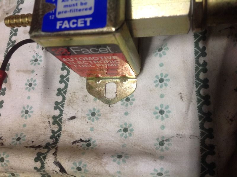

Just removed the fuel pump and it isn't the model I remember! Turns out I have a 7-10 psi model(40107 listed as a 574A on the facet purolator website) so looks like I am going down to the speed shop for a fuel regulator. This wiring thing has turned into a bottomless money pit...lol. The dellorto won't like above 5-6psi without the regulator I would imagine.

I would try it without a regulator first.
GR runs a 7.5psi pump for everything tested on his dyno- SUs, Webers, and including my Dellorto. Was no problem.
Cheap regulators are more trouble than they are worth.
