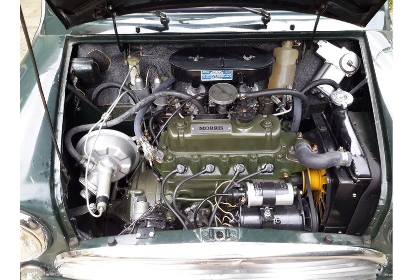

My 67 mk1 and 69 mk2 have them on an L bracket on the right side of the slam panel as per pictures. Have not seen many cooper S's that did not have them there.
Rod

My car (late 68) did not have the horn on the slam panel when I got it, was attached to the inner guard just ahead of the booster and there were no holes in the slam panel (that I could see).
However I saw original cars very close to mine in build number did have them on the slam panel, so I just assumed it had been in a front ender (it looks like it has had at least one front ender) ....so I moved to back to the slam panel.
But I wonder if they did do some on the inner guard???
I always thought the slam panel is a strange choice, its a bit in the way and is quite close to the solenoid. Theres plenty of room on the inner guard, even with the booster.

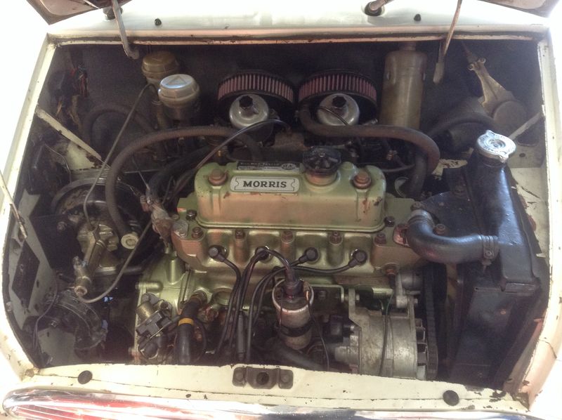

1970 s looks original to me?

Yes that is the other spot they were fitted. I have gone through a couple of hundred photos and about 20% of cars had them in that area. Your photo is a good one because it shows the bracket placement. Thanks

I've seen that on mk2's as well and always wondered about it but certainly looks original. Not really an option on mk1's though because of the Lockheed booster size and position of support bracket at front so would think the slam panel was the only real alternative?

Mine has the Lockheed and it was mounted down below it on the inner guard. Plenty of free space down there as far as I recall.
