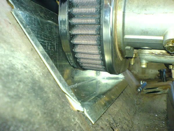

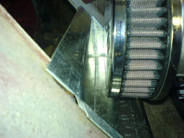

Weber "BOX" is made!
Woohoo thanks heaps Beanie :D
Steve paid me out calling it an 'ashtray' cos its unlike his massive air box that he has in his race car, so anything less is inferior :roll: :lol:
But it'll serve its purpose well - to seal the firewall up from where the Weber air cleaner needs clearance.
That's about it.
Now i have the fun task of cutting the whole out NICELY (there was a small *hack* cut into it, so i'm fixing it up)
I've started to cut it out a couple of mm from the line using an angle grinder, later i'll clean it up with a die grinder.
Make it nice :)
Now.... should i get it welded in? Or just screw it in so it can be removed at a later date, need that happen.

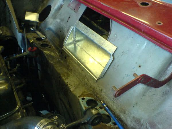

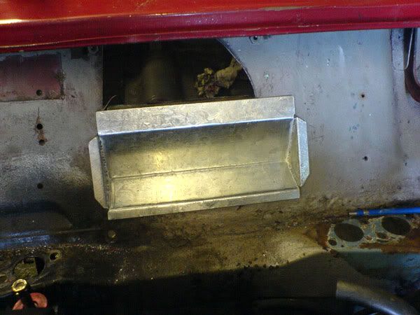

So heres some pics of my brutal hack job, which is very dodgey. :roll:
PostPosted: Mon Nov 21, 2005 12:59 am

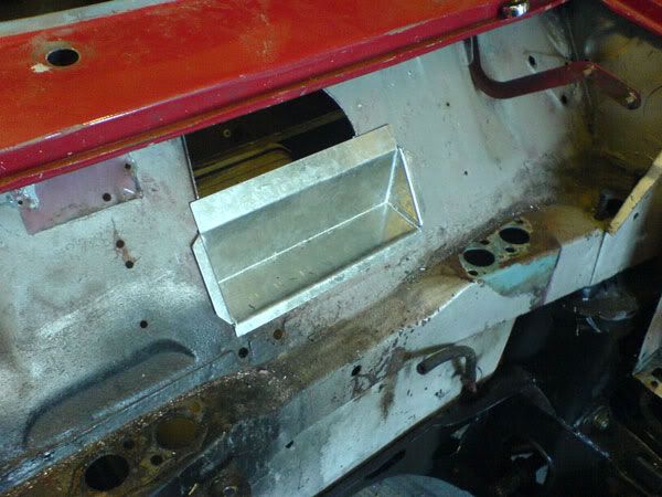

Box is only sitting there.
The paint shop will be welding in/ smoothing/ whatever they will be doing to make it look 'factory' :lol:
I'm thinking that it'd be neater if they had the box on the inside of the firewall then weld around the hole and grind back.
But i dont know.
I have no expertise in this field (well any field really).
That is all.
Comment away... at my brutal attacks.

willy wrote:
"Neatened" thankyou very much :lol:
The previous owner "hacked it up with a grinder", so i was just finishing off what that useless bastard didnt get round to doing.
Don't take it personal willy, was only havin' a go
I think it's going to be a bit tough to make it look "factory". To make it smooth & neat maybe cut the hole and box to match so there are no overlaps and butt weld it together. Would be a bit fiddly getting it to match up and more difficult to weld too. Consequently that's going to cost more, and more custom car than factory. How about fill in the hole above the box as above then drill holes in the flange around the box and weld it to the body through those, making a spot weld effect. You might say that will look dodgy but it would be a lot closer to how the factory would have done it!!!
It would be. Any reason why you cant?
