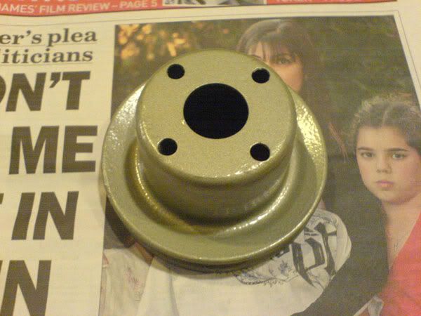

Alpine Green-ed water pump pulley.
What a relief!!

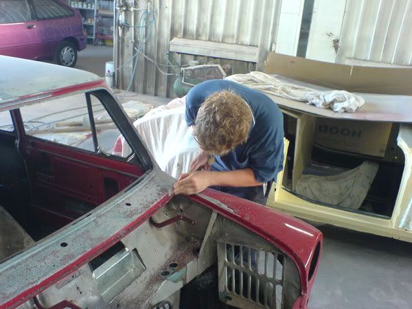

Only bit of work you'll catch me doing.
I ate my lunch off it
scrapey scrapey

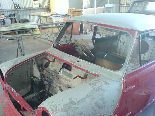

more
even more

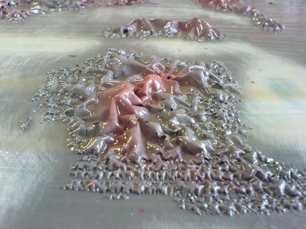

NOW THIS IS PAINT STRIPPING GUYS.
Not farken brake fluid; PAINT STRIPPER.

i took that photo,
just to show everyone that willy can and will do some work on this car :lol:

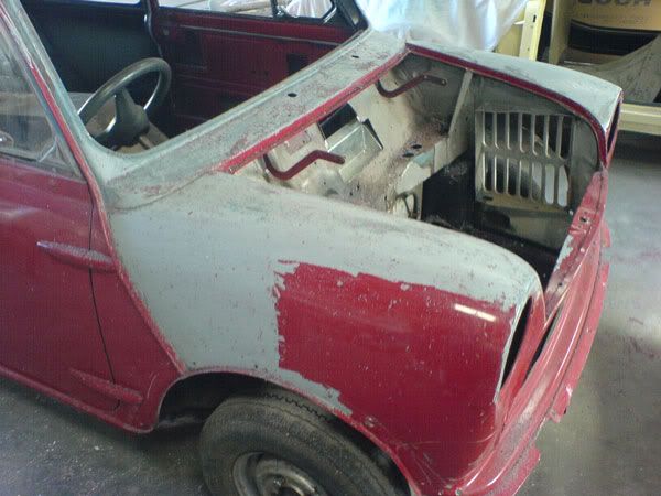

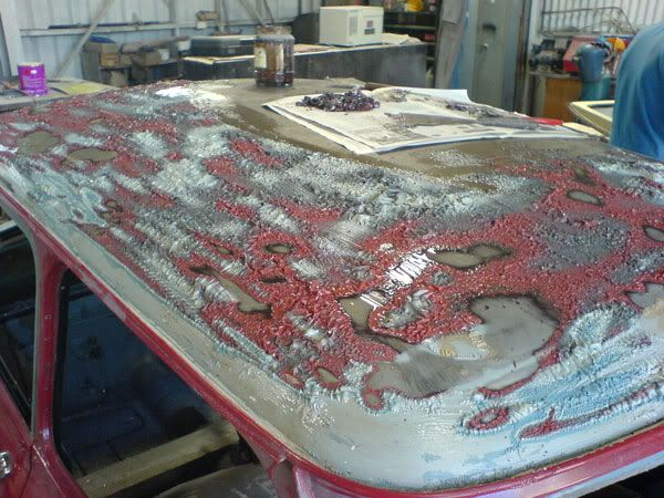

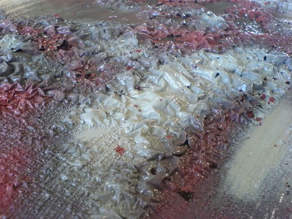

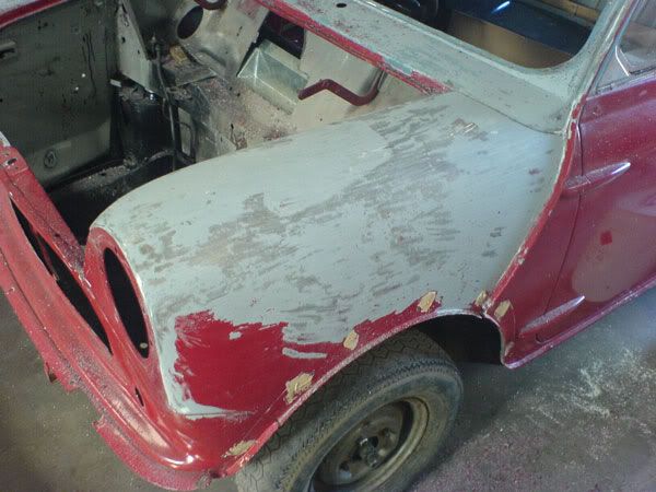

did you strip then scrape, or scrape then strip?
Mew
PostPosted: Tue Nov 29, 2005 11:09 pm
Joined: Mon Dec 20, 2004 7:34 pm
Posts: 944
Location: The Festival State
scrape then strip
Nigel Morton/ Team Brickworx
never late in a 998
PostPosted: Tue Nov 29, 2005 11:11 pm
Joined: Wed Jan 05, 2005 10:44 pm
Posts: 161
could you please explain what the reasoning was for that, and what kind of scraper was used?
Mew
PostPosted: Tue Nov 29, 2005 11:13 pm
Scraping - get the bulk off as to not get the stripper too gluggy when removing the paint
The stripping - remove the last couple of layers, and to avoid scoring the metal with the scrapers.
Scrapers used were just bog files.
With a slight radius on the ends and obviously a sharp edge.
