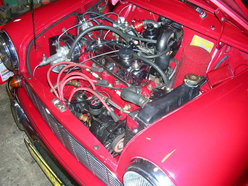

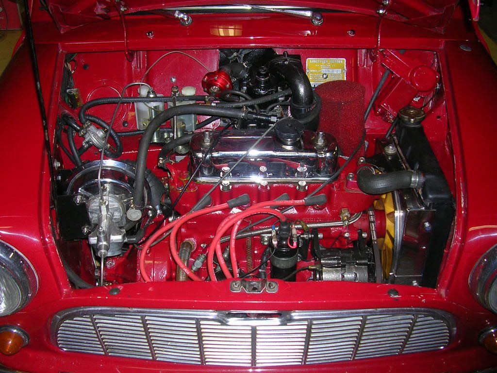

holy crap how nice is this :shock:
PostPosted: Wed Sep 07, 2005 6:27 pm
Posts: 5748
Location: Richmond.... NSW
Nice and clean.. simple but good. :lol:

Lots of sweet setups. You'll be doing well Cody if yours ends out looking like those 8)

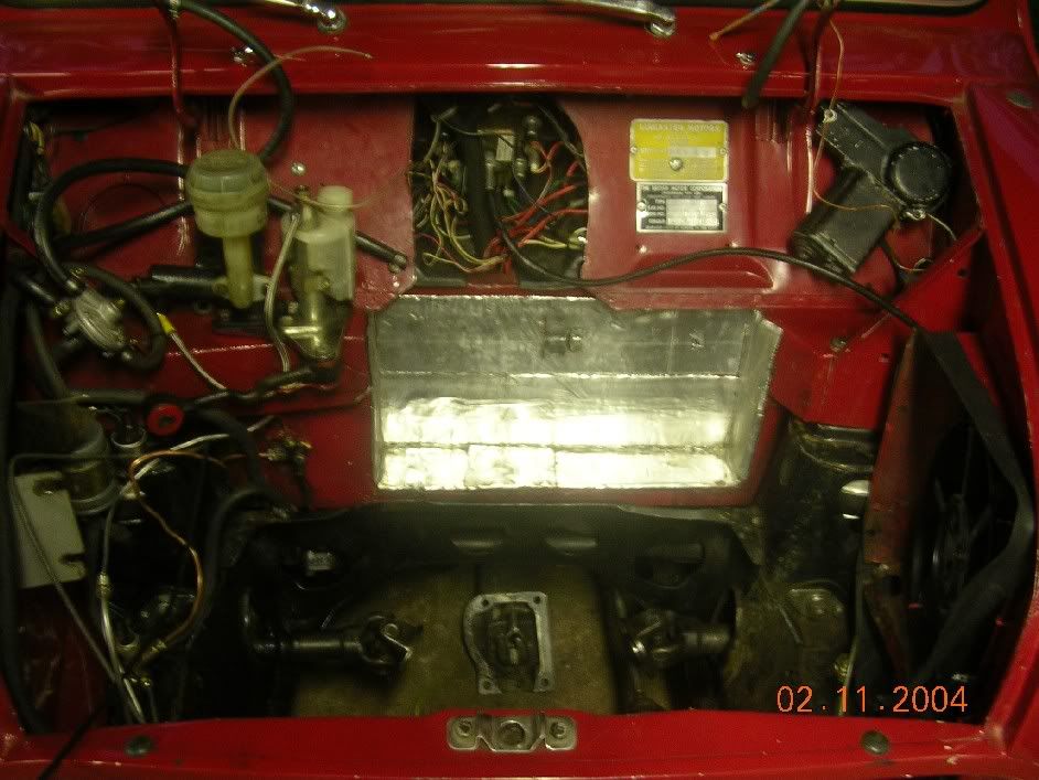

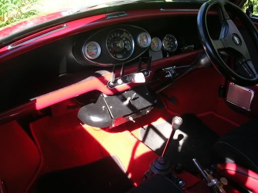

each setup has pro's and con's. I went the std metro conversion cause i did it in 96 when i did not know that much about turbos and i thought it was all easy mods (which it was) 8)
engineering the firewall was a piece of piss one visit by the engineer before and one after the box was welded in place but no painting and the other was for me to take him for a spin cause he loved it.
:D
i used std "S" brake set up wit booster and all was good.
i have had a few teething problems over the years but all and all i would not go back to n/a for what i want this car to be
GT1310 you are only at richmond, I am at kellyvile let me know if you want to look at it, but no can drive at the moment as gearbox is not happy :(
and i can still fit the MKI "S" heater in too :lol:
here are some pics
