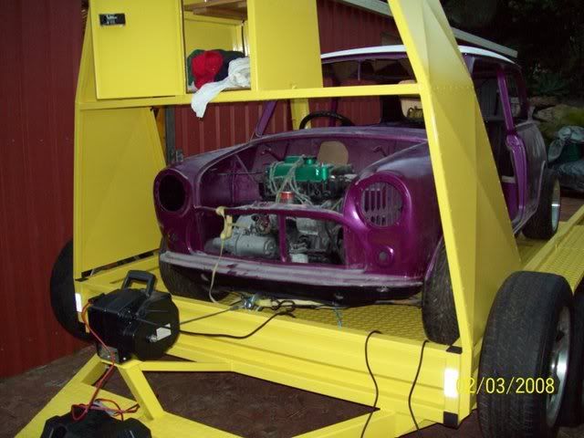

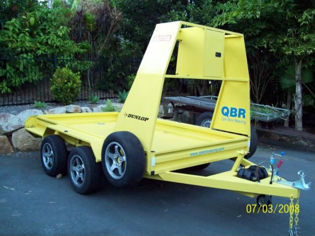

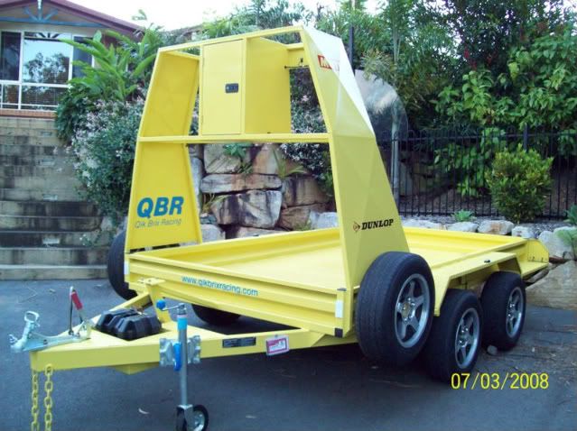

PostPosted: Fri Jun 20, 2008 7:11 pm
And here is mine.
Dedicated Mini trailer - 3300 x 1800 with in-built winch battery and tie-downs in each corner. Tandem axle for stability and of course electric brakes. Home built for the princely sum of $2,300. Sides are 200mm high so you can open the doors when loaded.
It has a tyre rack at the front for carrying the slicks or wets, and a locker to house the winch when its not in use. The ramps slide in underneath and locked in place by a spring loaded slide bolt. And as you can see, two spares as well.
The winch at work:

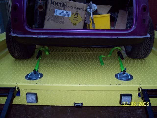

And the swivel D-ring ties downs:

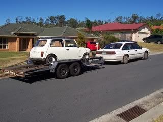

PostPosted: Sat Jun 21, 2008 9:09 am
Resident Haemorrhoid
Posts: 6815
Location: in da ACT
Hanra wrote:
I choose the cheap way and just hire one.... Wish i had the room for my own!!!
:shock: :shock: :shock: :shock:
whats that Bommodore doing in the picture
i thought you were a Ford man
Shame Hanra shame :wink: :lol: :lol:

PostPosted: Sat Jun 21, 2008 10:08 am
Posts: 6844
Location: Cairns, Nrth QLD
Thats my previous gas guzzler. Im neither a Ford or Holden fan. Just so happens that ive owned both. Ill never own another newish Holden after having that thing. I do want another Holden though (well Isuzu) I want to get my 1977 TX Gemini back....... Should never of sold it!
PostPosted: Sat Jun 21, 2008 5:20 pm
Theirs nothing wrong with a commodore and a hire trailer :D
The hire trailers are a bit heavy but are very good :wink:
