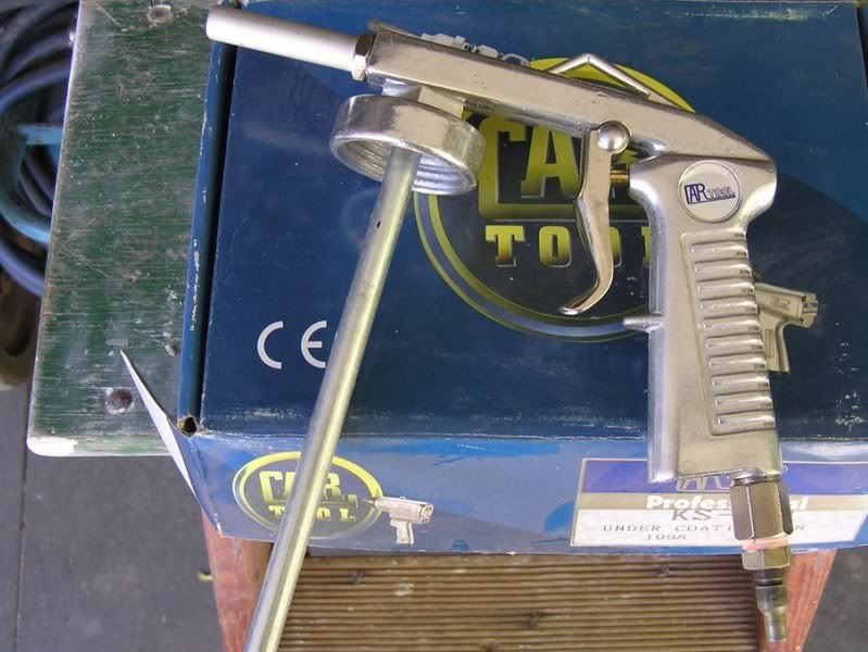

Here's a cheap gun

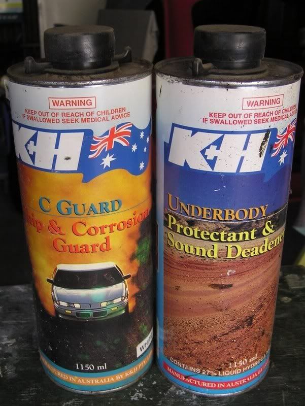

And here's the underbody sealer and stone chip, both in spay form. They don't need thinning. Just put the cans in the sun before you use them. I prefer Wurth products, but seem to have troble finding them unless you work in the panel industry. For body sealer, I prefer to use the 3M brand. Don't be tempted to use windscreen urethane as body sealer as some body shops do.
