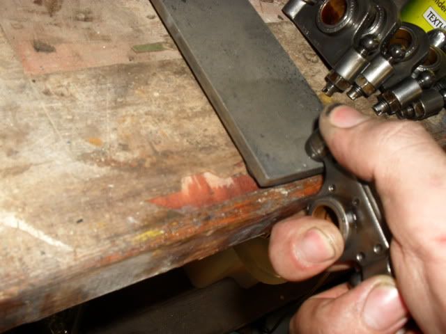

I just thought I would put this up there for the next person who searches this thread.
I had to touch up some rocker pads myself. They were off another motor and I noticed that the pads were just a little worn not hacked and deformed just a little worn.
If yours look like this, you may not need to grind them. You can just polish them out using a Diamond Lap.
Sadly, I didn't get a photo before I started, I didn't think to take phtoto's till after I started..... But heres some pictures of how and what they looked like afterwards..
In this photo, you can see that I have the Diamond Lap at the edge of the bench so that I can roll my hand down with the rocker to follow the existing profile. Try not to rock it sideways while you're doing this part or you'll have other problems....
Even if you think yours might be a bit far gone for using this method, I would suggest you still at least start like this, because you can remove material with one of these faster than you might think , and it might save you more time later if you catch my drift :)

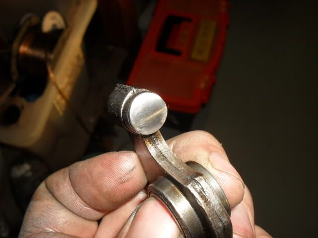

..... And here's the finished result, again sorry I didn't get a before photo.

A diamond lap. Is it a fine sharpening stone?
PostPosted: Thu Dec 30, 2010 7:19 pm
Posts: 1550
Its similar to a sharpening stone (as in ally oxide one you'd use for your chisels) but instead of ally oxide, its a steel (sometimes aluminium) back with diamonds encrusted in it. They stay sharper longer, they do in a lot situations provide a finer finish and you can remove more material quicker.... BUT WAIT THERES MORE :) unlike normal sharpening stones, these hold their shape. If you rubbed a normal sharpening stone in the same spot, you'd wear a low spot in it,,,,, not the case with a Diamond lap.
As far as oiling them goes, you just use water or kero (I was feeling particularly Greek this afternoon so I used Windex because it was handy and in a convienient squirty bottle :lol: ) oil is too heavy for these most of the time.
Sometimes I'll use this in the place of a file too. If I have any burs or bad fretting on the tail of a crankshaft, I'll rub it with one of these because it will only remove high spots.... (sure, if you sat there for a week you might start marking the rest of the crank :lol: )
