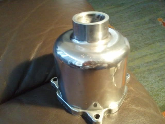

    The 0-30PSI adjustable regulator will be mounted on the bulkhead near the LHS engine steady mount just above the line where the original fuel pipe emerge from.
8)

    Thanks to a suggestion from Fat Boy Dave, I'm now thinking of mounting the fuel regulator in the boot near the tank. I understand that there will be a slight drop in pressure, but that can be easily fixed by just cranking up the regulator. This will mean I don't have to run a fuel return line... which is great because I just hate crawling around under cars!
    The supplier of the carb adapter, has stated in a FAQ on his web site that the run from the regulator should be no more than 3 foot. I have requested more info from him, hopefully I might hear from him by the end of the weekend. Discussing this today with Mick, we both thought... just suck it and see. But being the techo type I would like to know what the reasoning was behind the statement. If anyone reading this knows why, please let us know.

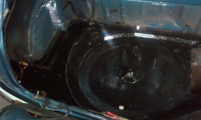

Day 6: - KillRust to the rescue
    Rust and more rust. The boot lid seal is perished and has gone hard, it has let in water that has rusted a nice circle where the spare wheel normally sits. If I had the money and knew how to MIG weld, I would have preferred to replace the wheel well, but I decided to just convert the rust using a phosphoric acid product, and then KillRust epoxy black paint over the top. A previous owner has done the same. Does anyone know of short courses in MIG welding over this side of Melbourne (I'm in Werribee):?:
    Here is a picture of the KillRust'd boot floor. Image
    Not pretty, but hopefully it will buy me time until I can do it properly.

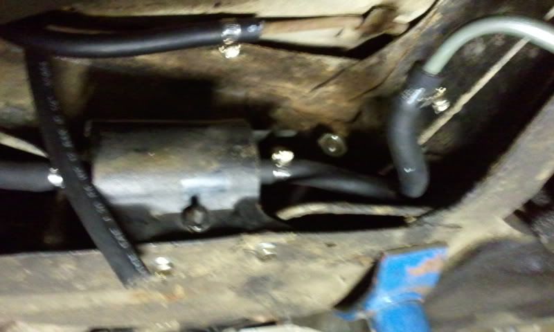

    Decided to use a Ryco Z578 EFI filter in the Rover filter bracket. The reason for this is I couldn't locate anyone within the local area that could sell me the correct sized inverted flare tube nut's. The Z578 comes with 5/16" tails and it fits in the Rover clamp also, done deal!
    Here it is before fitting to subframe.
    Here it is mounted on subframe. Had to drill a extra hole (6.5mm diam) towards the rear.

    I remove the Ryco Z578 EFI filter and fitted a Ryco Z200 EFI filter, as Andrew (afh001) pointed out that the Z578 uses a quick connect system, and I needed 5/16" barbs.
    Here is a picture showing the Z200 mounted in the Rover filter bracket. Excuse the blur, I had the shakes... low sugar levels I think.
