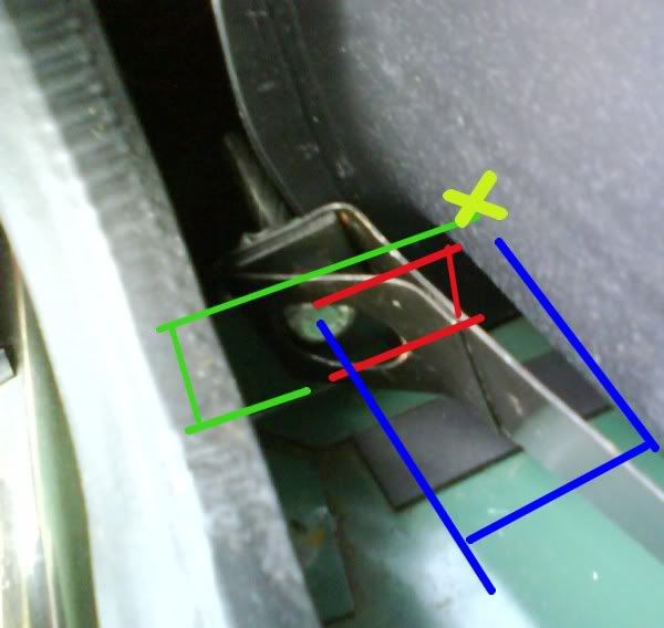

I need to make a bracket for my car that allows me to fit a late model fuel tank.
The early tanks had the strap go over the tank and mounted to the floor, but the later tanks had the strap go around the tank and anchor to a bracket welded into the floor the early cars don't have.
I need to make a conversion bracket. It won't be welded to the floor so instead it'll be a bolt in job. I'll use the existing captive nut in the floor and the rear subframe mounting bolt to hold the bracket down, and and a vertical component can have the hole for the strap to screw into.
What would be very useful to me is if anyone can get me the location of where the hole in the bracket needs to be relative to the subframe bolt.
In the above image, red is the height of the bolt to the floor, blue is the offset of the tank bolt to the subframe bolt, green is te offset of the bracket face to the subframe bolt and the yellow cross is roughly where the subframe bolt would be.
Any help at all would be very much appreciated.
Thanks.

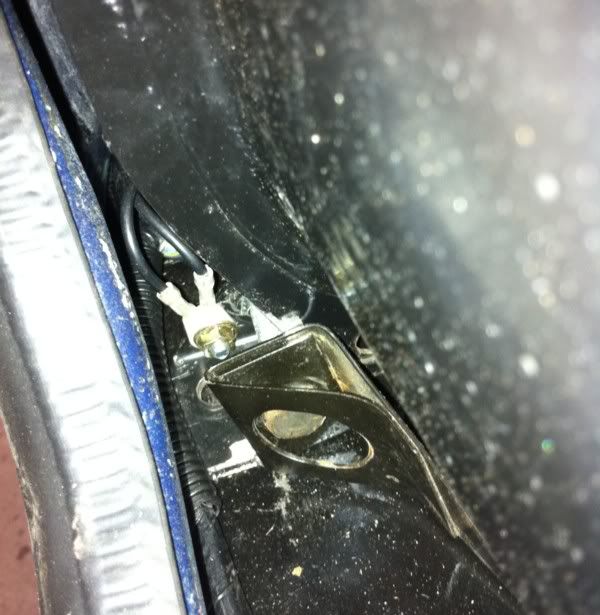

I'm fitting a late rover MPI tank as well to my '68. What does your bracket look like? Is it just a right angle bracket that bolts to the original captive nut that the early tank strap fixed too? Sorry, but I'm visual... could I be a pain and have a picture? :oops:
PostPosted: Wed Jan 19, 2011 12:14 pm
I'll get a photo of it if I remember some time but as you said, just a right angled bracket mounting to the captive nut.
I used the rover tank, strap, the 3 inch bolt and the clip on 'captive' nut. The bracket is only little, less than 2 x 2 x 2 inches.
It's straight forward to set up, the only trick is that there is a hole in the bottom of the fuel tank that looks like a mounting hole: it isn't used at all, the bolt at the end of the tank strap goes under it.

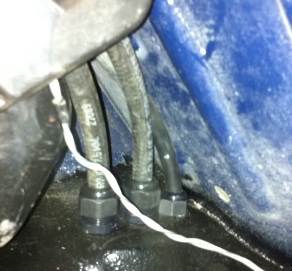

Want photos of where the fuel hoses go through the floor whilst I'm in there?

Wow that was fast service! :lol:
I was wondering what the hole was for... More photos the better, I have to drill one more larger hole and a smaller one for the over flow/vent. I'm putting the fuel regulator in the boot and the rover fuel filter on the subframe underneath. See http://www.ausmini.com/forums/viewtopic.php?t=67644&start=32

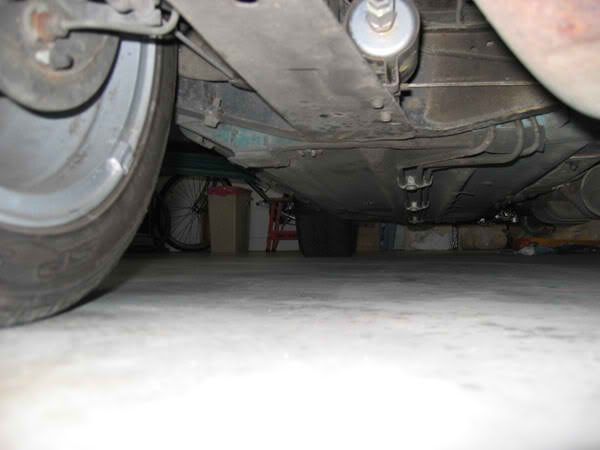

Handy to know. I've got a brand new filter and a S/H Rover filter bracket. It mounts to the subframe via two small bolts. Here is an image I gleamed from the net:
Unfortunately even though the two holes are there, the filter bracket fouls on the brake pipe that runs near there. I guess the Rover pipe lines are routed differently. Never mind, I'll just move the filter back to the rear of the car by one hole and drill a new hole. :roll:
PostPosted: Wed Jan 19, 2011 3:51 pm
I have the rover filter and not fouling brake lines, I'll measure how far back it sits.
PostPosted: Wed Jan 19, 2011 4:35 pm

PostPosted: Wed Jan 19, 2011 9:13 pm
Here's some photos.
Sorry they're useless, but that's what happens when everything is the same colour.

Harley wrote:
Here's some photos.
Thanks for that. I can now see the bracket quite clearly. What are those connectors that you are using, are they bulkhead connectors?
