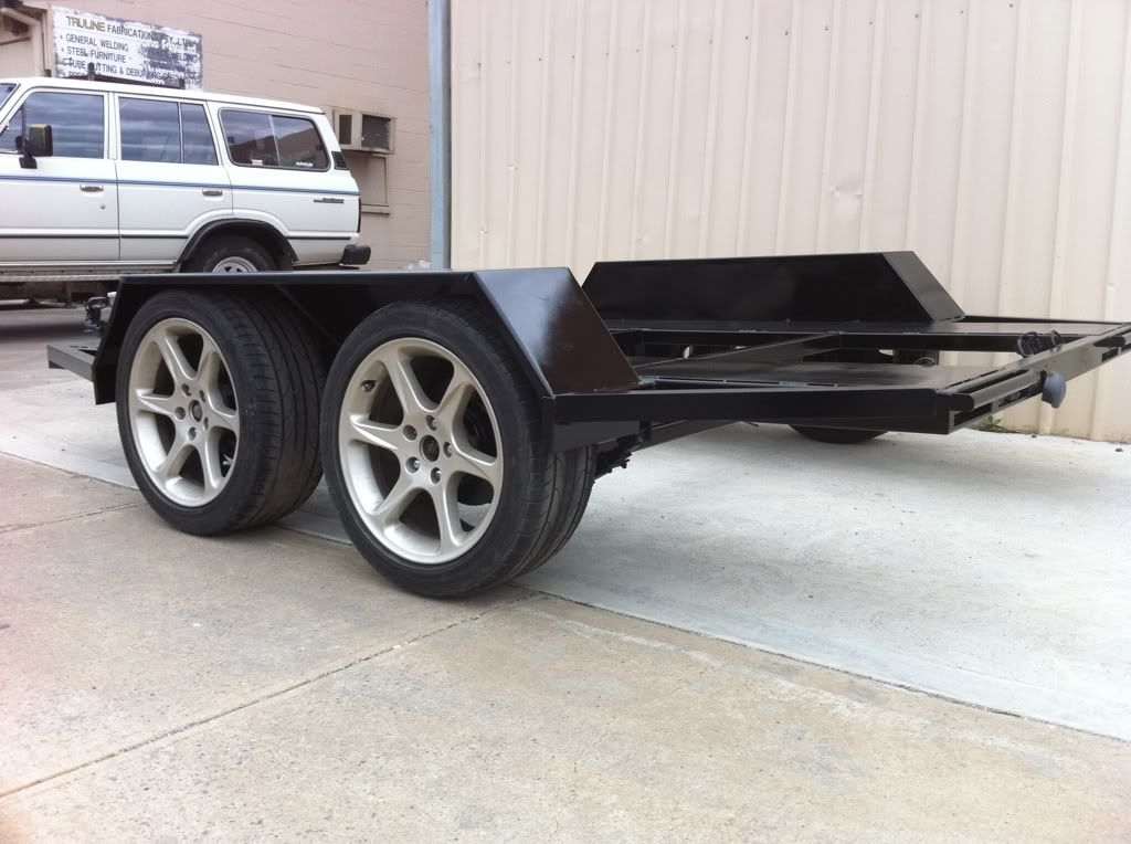

I know I had a pic of mine here before but cant find it. I had mine custom built by austrailers at Campbelltown a few years ago. Its light and easy to move around, the wheels rest against the front rail and the lowered section allows sump clearance, the doors clear the guards so you can drive on and off very easily. I would go the tilt option now but the ramps are easy enough. I also have steel belts which go over the tyres with nuts welded under the floor so they can be bolted stratight on and allow the cars suspension to move around, also has two tie down points at the front of the a frame so there is enough room to use ratchet straps and tighten them if needed and a safety chain point on each corner.
Very nice! Would you mind sharing the approx cost?

I paid about $2500.00 5 years ago but that included the 3 new alloys rims and brand new light truck tyres as most come with second hand stockies.

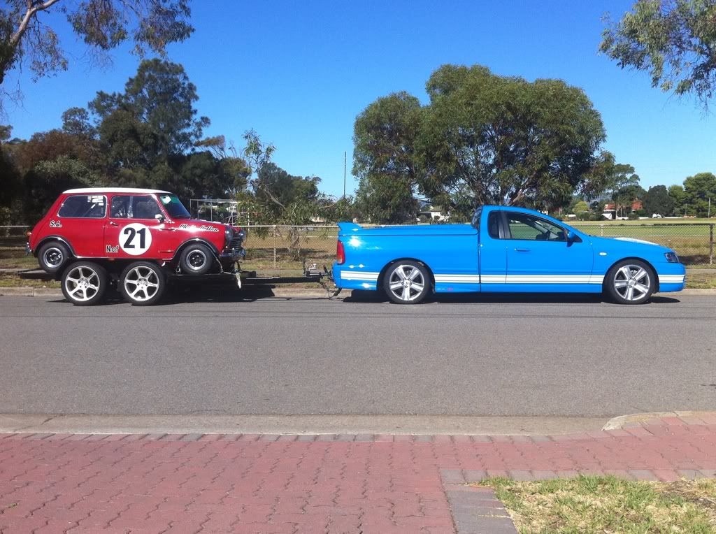

as seen before this is mine
Tandem axle , rocker springs ( 3 tonne springs too big in hindsight), hydraulic Front disks , tows like absolute dream ...
i chose to have ramps as its just simple , and when i eventually get a winch i will be able to load the car by myself ( ever tried pushing a dead car onto a tilt trailer ? mind you Wobbles55 does have a very nice tilt one ...
i will post photos latter on how its tied on ... over the front wheels and locked down to the tray ..
