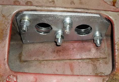

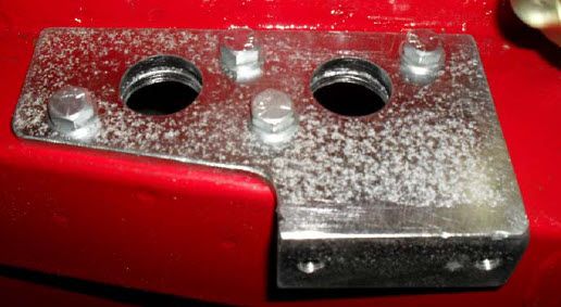

Here are some pic's of the Engine Steady that GTmowog made up for me. It is his design and his handy work.
It is pretty nifty, Two plates that sandwhich the bulk head and then an arm that comes off the front at the same level as the top of the bulkhead. This stops leverage action that the normal one has. It made a huge difference to my mini. I seem to have lost a lot of the vibration that I had previously from my motor. It is quite lumpy so it was annoying. Now that this is channelled into the body more it makes the bonnet rattle when idling but I can fix that.
TOP
BOTTOM

Whoah, ain't that the goods!? 8)
Nice work, that man!
PostPosted: Mon Jul 18, 2011 6:22 pm
Decent plate thickness is good and it's a big space saver aswell 8)

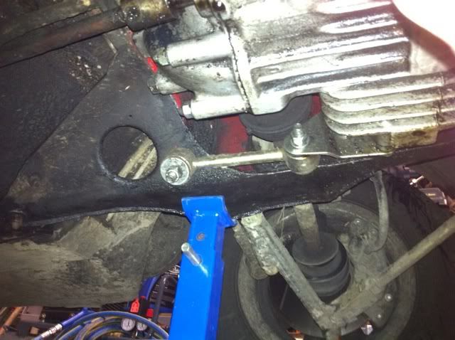

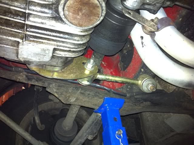

Here you go, crappy camera-phone shots:
Radiator side:
Flywheel side:

'Bout time!!!! :P :lol: :lol: They look great. :D
