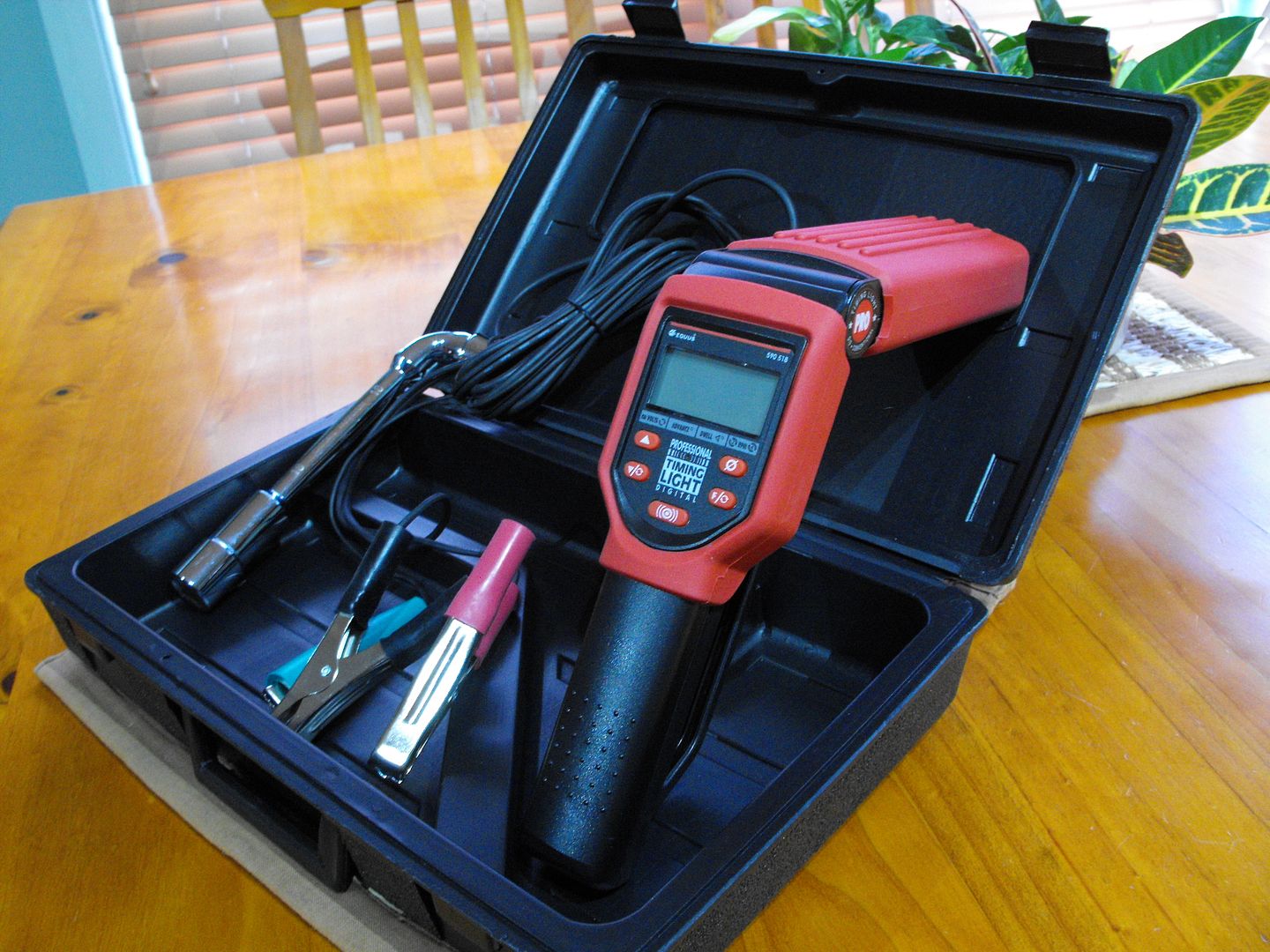

I'd been thinking about buying one of these lights for ages , but couldn't justify the price considering i have a perfectly good light that i"ve had for years ( only not dial-back ) .
Checked E-bay Aus to see what was about and bought a 5568 off this mob ,
http://www.ebay.com.au/itm/252024490659 ... EBIDX%3AIT
It turned up today ,looks the goods , just need some time to have a play with it and figure it out .

A bit of a thread revival. Looking for a timing light today and found this http://www.supercheapauto.com.au/online ... mendations
would this function "- Advance angle metre: (2 & 4 cycle DIS & Conventional): 0o to 90o (+/- 0.5% accuracy)" be the dial back advance feature that is mentioned in the thread?
I have a problem.. apparently
PostPosted: Sun Jan 10, 2016 1:19 pm
Posts: 5123
Location: The Internet
It looks like a dial back timing light. It has the same features and looks very similar in design to the Innova 5568 - Probably made by the same people and re-branded.

Beauty! I decided to grab it while I was out. But haven't taken it out of the wrapper yet.
PostPosted: Sun Jan 10, 2016 7:03 pm
Looks the same as my Innova, right down to the cable plug.
