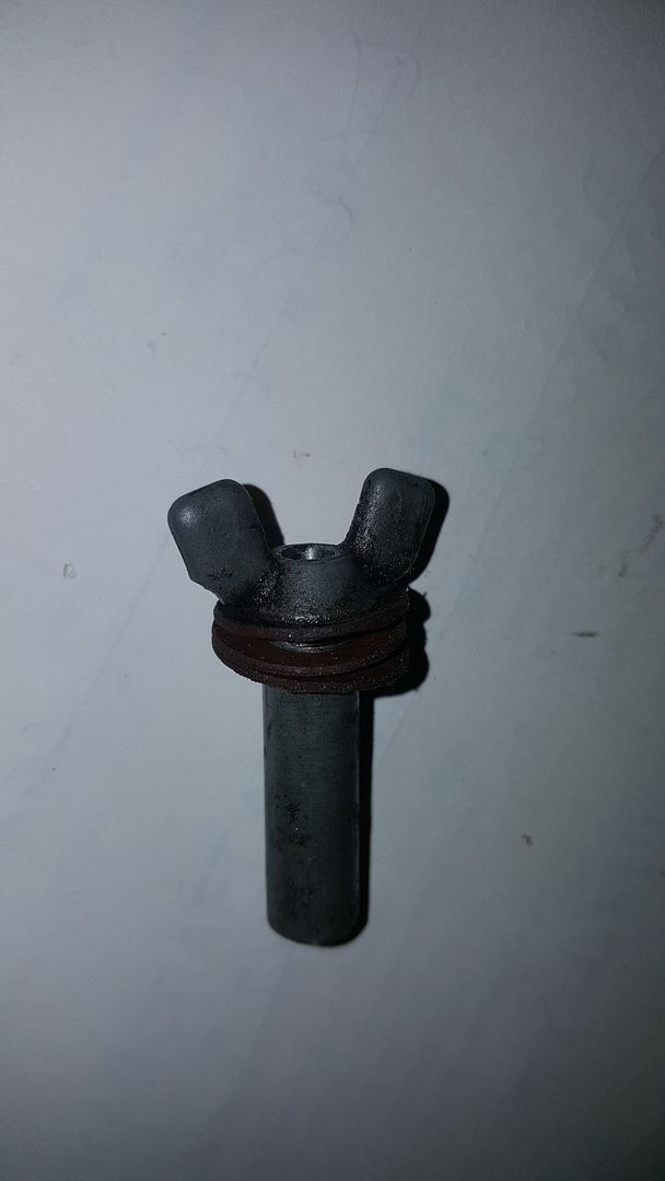

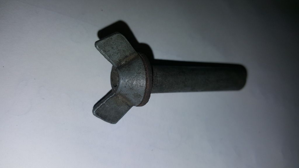

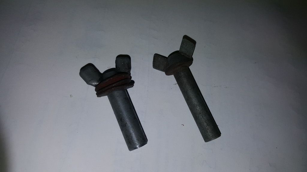

i have these 2 types
now i think (& my book also tells me) that the one on the left is the Mk1 type
& the one on the right is Mk2
but i`m not 100% sure & i`m not even sure if the change-over was actually at the same change as MK1 & Mk2,,, i`m thinking the factory ran out & had another batch made & probably to do with the difference between the Phomy & the Aussie air-filter housing difference maybe?, John Smidt will know more than me... i wish dad could come back from the dead & enlighten us all :-(
my book lists the left one as MK1 17H8380 @ 1&1/4" long
the one on the left as Mk2 12G2705 (no length listed) but is obviously slightly longer than the other
this is the one on the left ,,, i have a few pairs of these-->
this is the one on the right, i only have one pair of these & are not going anywhere :-) (sorry, they`re for my set of twins)
Yes Matt I've tried to figure this out too. The ones with the more rounded wings are also often fractionally too fat to fit in a Mk1 lid unless the holes are worn or adjusted larger.
I think some of the later thinner air boxes may have used these wing nuts and as you say there may have been some mk2 with these.
I know someone with a very original Aussie Mk2 with the thin air box and rounded wingnuts.
When you look at later English Mk 3 Cooper s u start to see the rounded wingnuts too.

Like you say, Matt, the parts books and fiche are a little confusing on this topic. Part numbers are certainly listed but there isn't consistency.
The early parts book HYL3262 for the Mark 1 Cooper S shows the wing nut as 17H8380.
Later parts book PUB1056M for the MK II Cooper S shows 12G2705.
Curiously, the Clubman parts book PUB1052 reverts to the earlier 17H8380 but the much later Mini parts microfiche shows 12G2705. :?
Below is a picture of the Clubman GT engine in the crash test photos. Make your own decision on whether it's like either of Matt's nuts. :shock:
If you want to research further here's a link to Somerford's parts page. Hover your pointer over the number in the exploded diagram to see more info on that part. For example, it shows the part numbers for the various twin SU air cleaners used during Cooper and Cooper S production.
http://www.somerfordmini.co.uk/eshop/in ... age&id=159
Finally, don't necessarily assume the shorter wing nut was used on the narrower housing. It's possible the threaded rod in the carby throat is a different length for the different housings. Also be aware this style of wing nut was used on later air cleaner housings for single carby application, such as 998 and 1098.

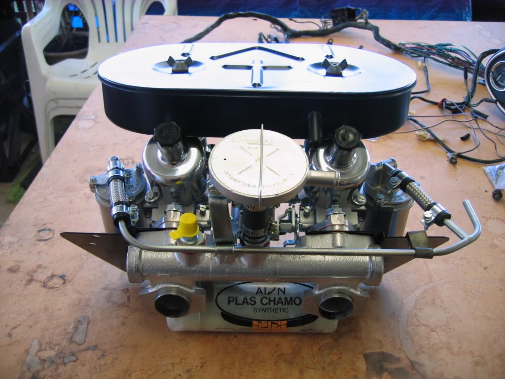

this is the air box on my mk1
