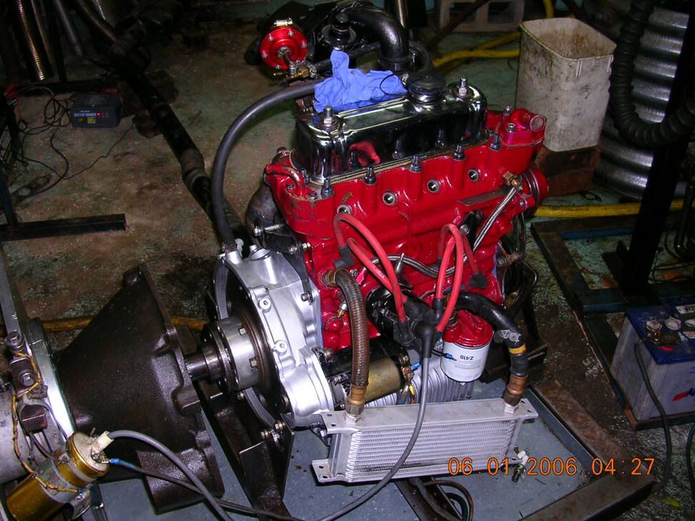

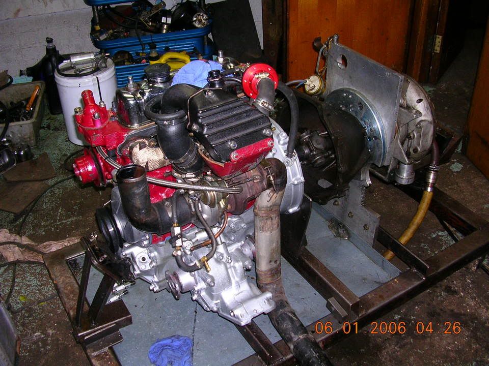

PostPosted: Mon Jan 09, 2006 3:59 pm
Posts: 1170
ok well what a day i had at GR's last Friday.
got the complete motor to GR at 920am and we both worked on the Dyno with the help of Greig Maluire and we tuned the turbo beast to get a whopping 160hp at 7000rpm on 11psi of boost, we had a fair bit of trouble getting the fuel mixtre correct as it was rich rich rich the whole rev range but in the end we settled for a modded needle and all is great.
GR said he was very impressed with the build and the engien set up and believes the otor will get a good 180hp on 15psi with an intercooler
he also said it was one off if not the highest hp A series motors he has ever had on his dyno, so that alone is a great feeling.
motor should be back in the car by this weekend and we will then see how it drives (****** quick i think)

Boosted, so that was you then I met at GR's on Friday when I walked in with the clutch thrust bearing problem! I was going to ask you what capacity is your motor.
There was a fair bit of smoke going up GR's dyno chimney while I was walking down the driveway. :)
Dino.
