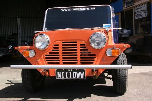

Completely standard, normal old 998.
That setup has now been removed and replaced with a draw though SC12. The standard engine underneath still wont die.
Clean oil, not too much advance, plenty of fuel and a water injection system keep it alive. . .
