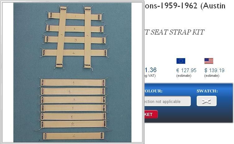

My pick would be the elastic straps like in my pics stretched nice and firm and a wire base with foam covering both back and base.

What about going to this kit?

A motor trimmer will have everything needed. You shouldn't need to buy a kit. Give him the old straps and he will reuse the clips/hooks. He'll have elastic and foam already. Maybe just buy a wire base, or he can make a base with straps.

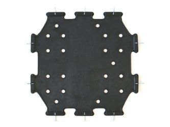

C705 MINI RUBBER SEAT BASE DIAPHRAGM: 1960 - 1993 x 2 £ 28.50

To redo in the way the Aussie seats were done all you need is
*two different thickness of foam
*foam glue
*elastic webbing for back
*either wire or rubber base
Again a reminder the austalian seats are not necessarily the same as English seats and where trimmed differently so foam and kits from UK may not fit the same.
