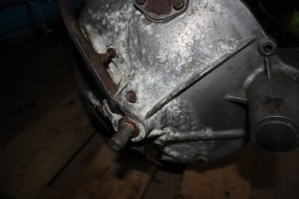

well, i have this to clean up and fix
It seems the previous owner wasn't too concerned about brake fluid leaking everywhere :roll: . Whats the best way to clean it up and un-sieze it??
Dusk Blue
1964 850
PostPosted: Wed Feb 02, 2011 6:32 pm
Posts: 39757
Spray with WD40 or Penetrene (better) to the clevis pin and the throwout bearing shaft, leave it a while to soak in then apply some heat to the cover. Hot air gun, gas torch, whatever. :wink:
