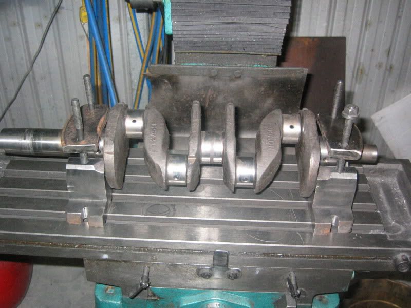

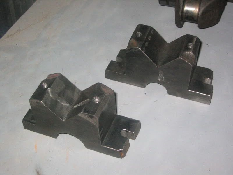

Posts: 2372
today I finished up some V block type things so I can wedge cranks on my mill with moderate repeatability..

Posts: 39755
You will need an adjustable stop block to put under the crankpin, the crank will move during the cut otherwise. :shock:
Yes I know this...:mrgreen:
I made one out of a 1/2" bolt and a pair of locknuts.

yeah mate thats my next job, I will make a spacer that bolts onto the bigend and then to my table then I just have too move it around so I can get all the web things... the crank will need to be moved 4 times to wedge the whole thing.

It should look like this when finished milling.
Don't take the cut back onto the counterweight beyond the main bearing journal or you will lose counterweighting.
See on the front web here, the cut runs out just above the edge of the main.
After milling, remove all the sharp edges and radius it around the crankpins with a linisher (fixed belt sander).
An angle grinder and flap wheel is too hard to control on this job. You might slip and mark the journals... :shock:
