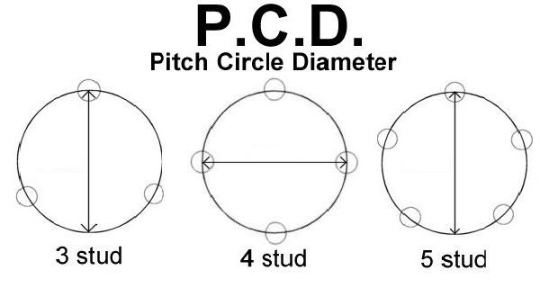

Also, what is PCD?? I know you measure centre to centre, but is it from the stud holes next to each other or diagonally?? And is the 4 inch measurement for Mini's right?? And what is the size of the bearing cap hole in the centre??

You measure from stud to the one next to it NOT diagonally.

A PCD (Pitch circle diameter) is measured diagonally on a 4 stud wheel.

A picture being worth a thousand words & all that...
