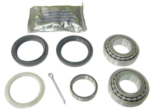

Should I repalce the front wheel bearings with cooper type?

Question 2: Not really, save yourself the dough unless you're really gonna thrash it around corners. Good tip though is that MiniPsares sell the Timken Classic Bearing Kit for minis I think for about 1/2 of what it costs locally, and they're taper roller.
Question 3: Yes, it keeps the grease in. It's part of the bearing seal kit.
