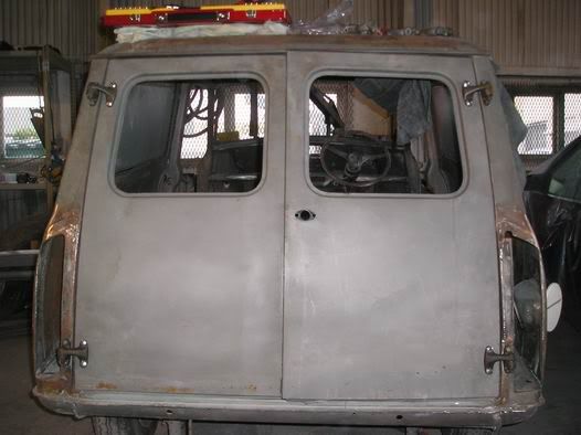

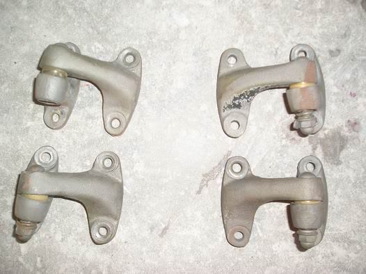

I have a 68 morris van and the rear door hinges were taken off a while ago and once putting them back on, i have no idea where which one goes... So i have a pic of all 4 sitting on the ground could any one maby advise me to where which one goes? Does the nut sit at the bottom of the hinge or does the pan headed end with the slot in it sit at the bottom? Any one have a pic of the rear of their van that they could post?

PostPosted: Thu Nov 24, 2005 5:38 am
Nuts are on the bottom with the Pan Heads on top :wink:

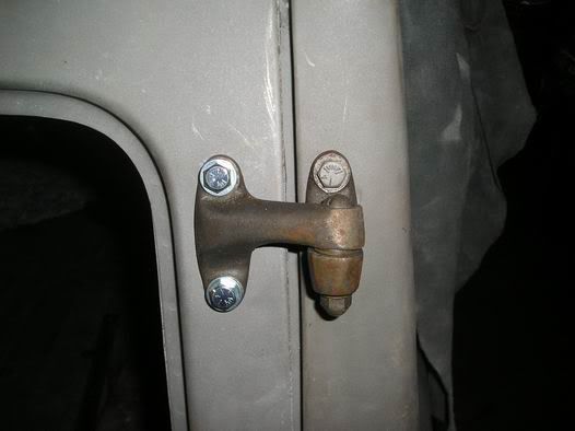

Ok here's a pic from Matt... Thanks

Yeah thats right, i though i had them all in the right order but they dont seem the doors dont seem to fit properly,
some how the van must have warped...
This is a pic of the top left hinge as you are looking at the back...
This is one of the topr right
See the difference in the gap between the door and the rear of the van?

Do the doors have an even gap down the middle?
The hinges could be a bit knackered as well
I don't think even panel gaps is a mini's strong point

Have a look on the back of the hinges - they have a code stamped into them
LL = lower left
UR = Upper right
etc.
At least that the case on the roundie PV I am restoring.

From this pic the gaps dont look so bad, but they are out, and the doors clash in the middle. And these hinges
are new so they shouldnt be stuffed, and ive looked at the hinges and there is some markings on the back but
nothin that lets me know what hinge is what...
Life's a garden.... Dig It!

Yeah i have 4 new hinges. The first pic is one of the old ones, which i had to replace cos one of those bolts snapped
