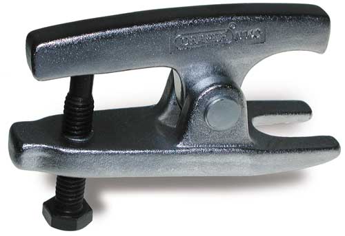

how can i split the ball joints with out the puller tool

Belt the FRONT of each top and bottom arm.
Undo the balljoint nut until you have exposed a few threads (still so the nut is grabbing)
then belt the control arms HARD.
WIth a heavy mallet.
You will know once the balljoint is loose because (with the top) it will slip down.
The bottom... just use a pry bar and belt the bottom arm.
I'm sure someone else can explain it better :lol:

OR...go spend $30 at Autpro / Supercrap and get ureself a splitter. They are REALLY worth it.
Autopro Sell These ----
