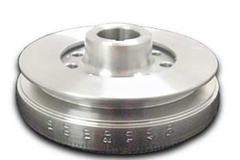

I find TDC accurately with a pushrod in #1 plug hole and a dial indicator, then mark TDC on the front cover, and on the harmonic balancer.
Then I put 15* and 30* marks on the balancer pulley by measuring around the periphery with a thin 6" steel rule.

Dia of balancer (outer part), not pulley = 120mm.
circumference is 120 x 3.1416 =377mm.
1* therefore = 377/360 mm = 1.047mm.
so, 15* = 15.7mm
and 30* = 31.4mm.
Here endeth the lesson.
Enjoy! 8)
<edit> Of course if you have the $$$ handy, MiniMania sells this nice Bling S/S one, already marked in degrees. :P
