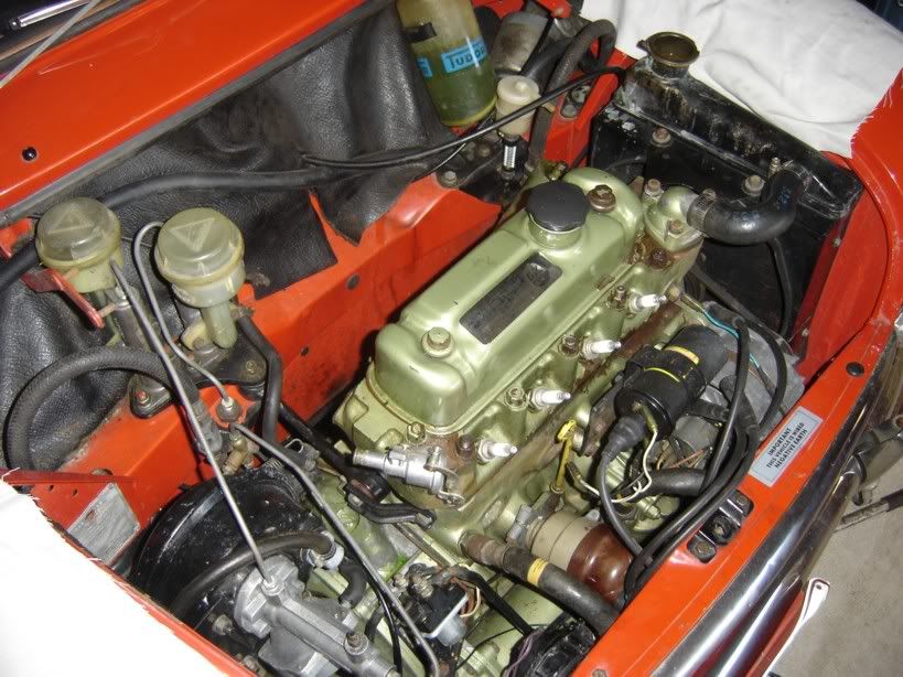

Can anyone tell me I got a set of new brake and clutch master cylinders (plastic type) and they didn?t seem to fit in there appropriate spot until I swapped them. Are they the same thing or are they different? I hope this makes sense??can anyone help?

like this i guess

Yeah, but the clutch and brake master cylinders have different bore sizes i think?

Posts: 319
yes i think you are right and after lots of look on the net i seem to find these mounted this way so i am guess it is right

Posts: 18888
Mounted with both facing the firewall will drive you crazy trying to get the brake fluid into the resevoirs without spilling any on the flash looking paintwork.

Posts: 319
on a closer look i found min/max lines on the back so i figured this is the way that it fits an early model mini, i don't know just guessing :?

Posts: 39764
Yes that is the way original tin tank ones were too, they were handed like these new ones so you cannot mix them up.
Good idea, considering the number of Minis out there that had 0.7" Clubby brake MCs incorrectly used on clutches instead of proper 0.75" ones.... and people wondering why they had clutch throwout probs.:x
:idea: If you want to save your paintwork, just carry a small plastic funnel... :wink:
