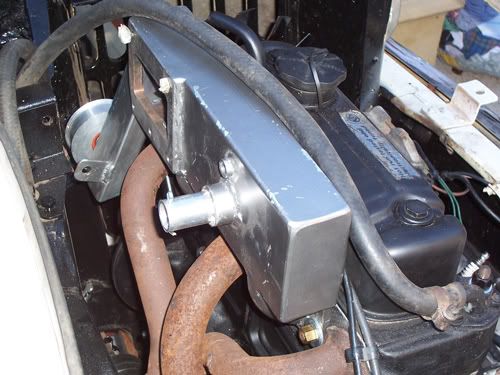

See where this hose goes:

dang, thats where my temp sender is.. so where is the temp sender ment to go,
PostPosted: Fri Jun 16, 2006 2:04 pm
:shock: How did you get a temperature sender in there?
They go in the head nearest the water pump:

Sounds like it might be an 850 head , they didn't have a temperature sender . I've got a head somewhere here with a big nut welded to a bit of steel plate bolted onto the head where the heater hose normally goes and a temp sender in that , I'll just about bet that's what they did with yours .
