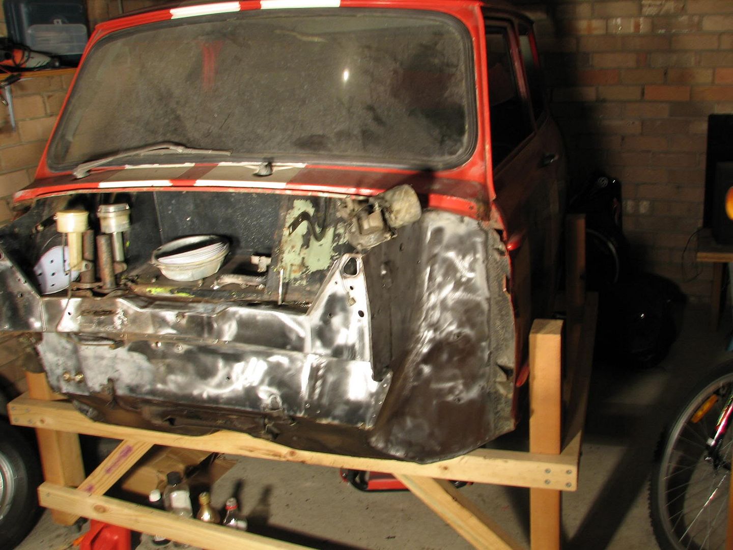

Started cleaning the engine bay.
For anyone who is interested in doing this You need a heat gun, paint scrapers, thiners to clean off excess stone gaurd, wire wheels, some paint removing pads and some dioxidine (rust remover).
