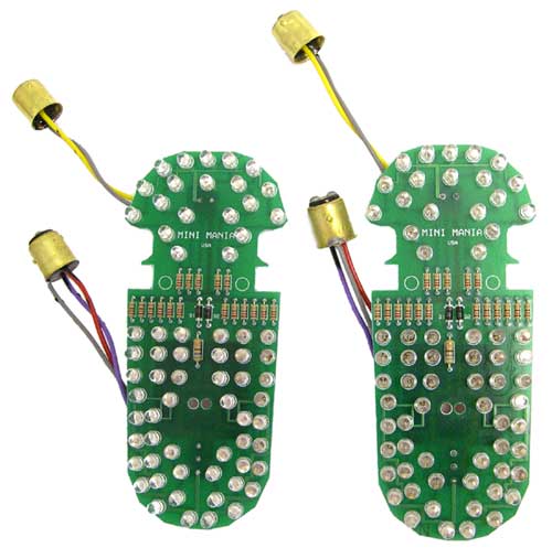

You can get PCB boards that go in MK1 tail light bases.
MiniMania sells them.
****ing expensive tho.
$140 a side I think from memory.
And thats US dollars. :shock:

Would be a fair sight cheaper to build your own PCB board with LED's on it, to suit whatever tail light assembly youve got. All you need is a bit of soldering talent, and basic electronic knowledge.
Cant just do LED's on the rear..... you need to do the front too or else they will look odd (delayed flash, especially at night.)......... and then the dash too :wink:
These are the Mk1 style inserts

They look great, be careful of the diode on the mini mania ones as the angle of the light transmitted has a small angle that you can actually see the light from.
They should be a flat disc type so the light is dispersed properly..
