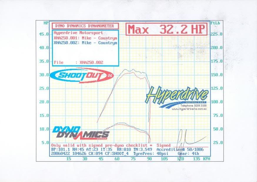

Shame it's got all that spam all over your nice graph, it makes it hard to read.
