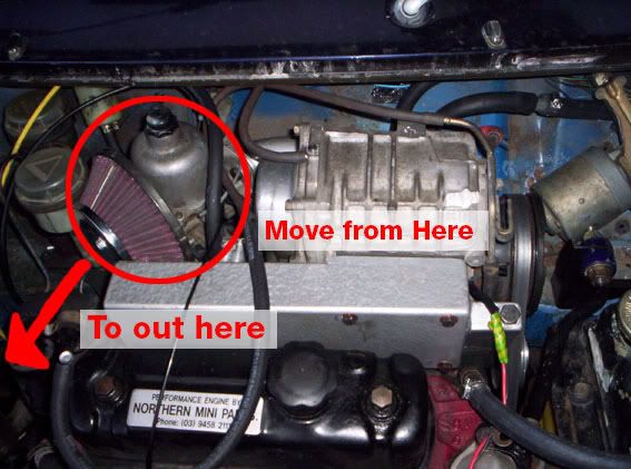

im hoping someone on here can help me. Ive supercharged the mini with 92's kit and alls good, but i want to move the position of my carby so i have easier access to the mix screw. Heres a bad picture of my engine bay and what id like to achieve, Basically i want the carby to be out kinda over the clutch area but doesnt have to be that far.

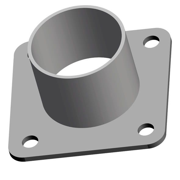

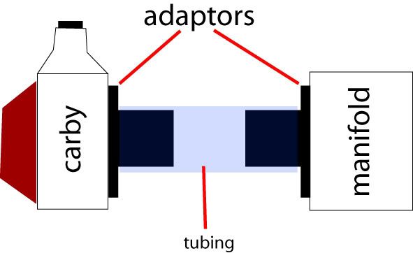

So after some thinking ive decided that i might just extend the the inlet manifold with some piping. To do this ill need 2 adaptors like these made up with the correct bolt pattern size for a HIF6 carby
side view of wanted setup
Ive been into various auto part stores only to be met with dumb looks and shown the same air filter adaptor that doesnt fit the small stud pattern of the mini su carby.
Id attempt to make them myself but 1. i have no welding experience and 2. i have no access to a welder, both of these combined make things a little hard. So what im after is suggestions to where i could buy some OR anyone willing to make them up for me for a fee:):)

the shop ALDI had welders for 99AUD the other day.
they won't be good but they are cheeeeaaaap
PostPosted: Wed Sep 13, 2006 12:36 pm
Got access to a lathe?
Turn one up from aluminium.
No welding then. 8)
PostPosted: Wed Sep 13, 2006 1:17 pm
Posts: 541
Location: Ocean Grove, Vic
nah no lathe, i have access to screw drivers, computers and paint
PostPosted: Wed Sep 13, 2006 1:32 pm
Posts: 1683
Go to an exhaust shop, they have helped me out heaps over the years making up that sort of thing
Daniel
PostPosted: Wed Sep 13, 2006 1:55 pm
Joined: Tue Mar 21, 2006 10:03 am
Posts: 734
Location: Melbourne, Craigieburn
What is the external size of the adaptor and measure the position of the stud pattern... I may be able to help.
Santo
"The Lone Ranger"
HI-HO Silver......AWAAAAAY!

Be careful, I thought the carb pipe to a blower was a tunable length, ie it can have dramtic impact on behaviour. It would make a grater volume that the blower (sucker) would have to evacuate before allowing the carb to respond. Which would result in a column of compressed unfuelled mixture everytime you put your foot down. When you backed of you would still have a momentary column of compressed fueled mixture.
I thought you always wanted the shortest possible inlet length between the carb and the blower to avoid lean on inital throttle and overrich on trailing throttle.
PostPosted: Wed Sep 13, 2006 4:35 pm
Posts: 11749
Check this is out. Its a good article
http://www.jagweb.com/aj6eng/supercharging_article.html
 Post subject: Re: I need one of these
PostPosted: Wed Sep 13, 2006 8:49 pm
kasperflipped wrote:
Hi everyone,
trent
Why not think about a clampable/lockable flexible drive extension for the mixture screw rather than risk compromising the inlet tract :?:
