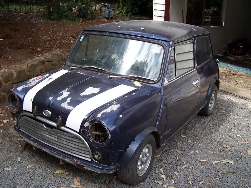

um it has been resprayed as cooper s rep but it was sprayed before that to here it is at the moment

i know where their is one of those in a paddock sitting with about eight clubbies to keep it company :lol:
