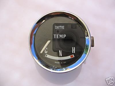

Would this gauge be more accurate than the standard clubby gauge? Would it be preferrable to have a gauge that has the actual numbers written on the face rather than just a hot, warm or cold section? I have a 1300 in my leyland and the standard needle seems to be moving more that I would like.

None of them are accurate as they don't have temp readings on the face, so therefore can't be calibrated accurately. They are only a guide.
They are however supposed to be matched to a correct sender to suit the gauge. Once you have the gauge and sender, you can immerse the sender in hot water from the stove and compare the gauge result with the temperature of the water measured with a thermometer. This gives you that war and fuzzy that the gauge works and that you can believe the reading.
You can take the water to the car and drop the sender into the water making sure to connect the sender to ground as well.
You tend to just get used to a particular gauge when they are ungraduated.

Another way to do this is warm the motor up with the rad cap off and a thermometer sitting in the top tank. 8)
Or, some multimeters sold now have a digital temp probe. I borrowed Gafmo's.
I was most surprised when I tested Barney's C-H (Mini K) temp gauge. The start of the `H' was only 74C, with correct sender and +10V from the electronic V stabiliser.. :lol:
Maybe somebody has fiddled the calibration inside the gauge- no matter, at least I know now he's NOT overheating!.
as others have said...all guages are only an indication and greatly depend on where their sensors are installed. Temperature in the head is most critical I suppose because if it overheats you can crack it or blow a head gasket.
So generally its a matter of personal taste...graduations or indication bands...the main thing is to make sure that after observing a range of driving conditions (including stuck in traffic) you check that your cooling system is copeing and you remember the range of indications you saw on the guage....anything out of the ordinary??? switch off and investigate (quick!)
