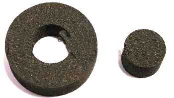

also there is a seal that slides onto the part that sticks threw the floor that the steering colum bolts onto.
it looks like a pice of foam that squeezes just like a bush to stop water getting in.
got this from the minimania site .
cant believe no one has used this as i can clearly see a gap betwen the rack and floor witch water can get in.
easy to make one up out of rubber...so if the rack needs to be taken out ill make one up.
PostPosted: Wed Nov 08, 2006 9:45 pm
Yep they originally all had a bit of foam like in the pic. :wink:
