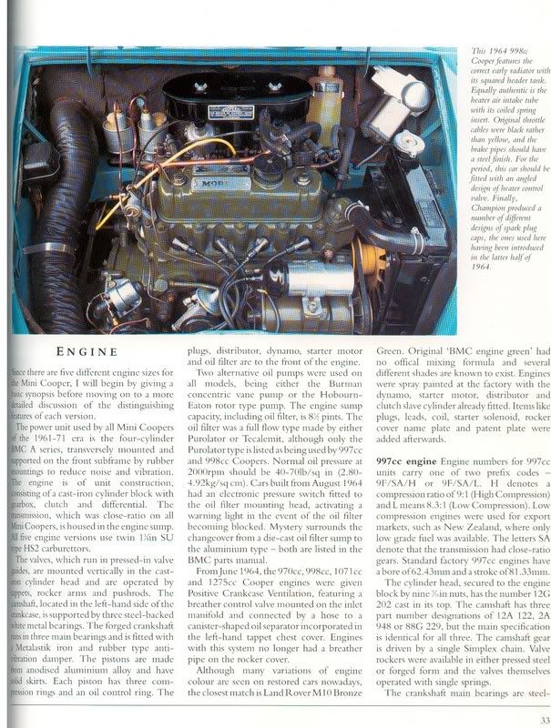

Yeah I had a PCV fitted to mine, but it is /was incorrect for the period. I was more interested in keeping a clean sump and driveway in this case.
With all respects to the ever knowledgeable and omnipresent benevolent Doctor I believe they did not. According to Parnell it is incorrect at least for the 64 model. Were they available in Australia in 65?
Here's the Parnell "Original Mini Cooper and Cooper S" page which gives a good picture of the bay. On the next page it states:
"Crankcase ventilation is achieved by means of a vent pipe in the left hand tappet chest cover connected to a shaped hose which feeds excess fumes down behind the engine block and out into the atmosphere."

Edit: I just read on further in the Australian section and found that if the engine number had a "D" in it, ie 9FD/SA/L then it did indeed have Positive crankcase pressure. oops
My engine had the prefix 9F/SA/L so was incorrect in having the PCV.

Hey Mick
I have that book and that is what has me wondering. As you said the book says if the engine no was 9FD/Sa/L then pcv, 9F/Sa/L was not, but my engine is a 9Y/Sa/H which of course the book does not mention.
I have been in contact with someone who knows of a 998 with documentary evidence of it being a '65 and mine is numbered after that, in fact mine is the latest known. All dated components so far looked at are late '64, I don't believe components would have made their way into a car extremely quick so that could also substantiate a date of '65.

With the last one reported as being produced in December 64, there's all kinds of reasons I suppose as to why it would be 65 badged. Parnell is not the be all and end all of minis, and there is a mistake or two in the book, fantastic as it is. Is there any old photos of press cars from old Wheels magazines or the like?
