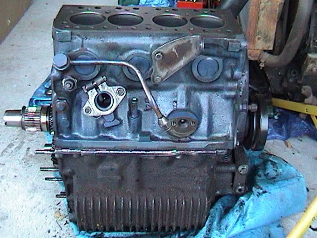

Here is a pic of the spare block after I have given it a little clean up and split it from the gear box.

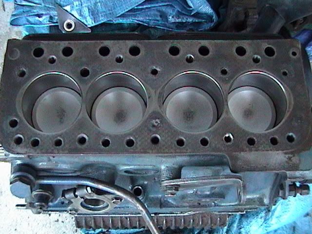

Here is a shot of the cylinders after I gave them a light rub with a scouring pad to remove a little bit of carbon build up.

Love the 45kgs of protective gunk covering the gearbox casing :wink:

:) :) It was over the whole thing. I had to sit there for hours with rags cleaning it off the block bit by bit with a little bit of WD40. I wish I had degreased it a couple of years ago before I pulled it out of the Clubby I rescued it from. The CV/Uni boots had desintegrated so I presume that's where most of it came from :?: :?:

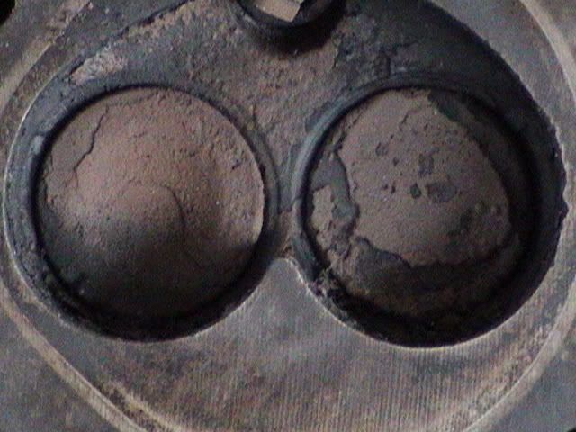

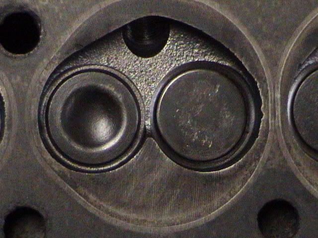

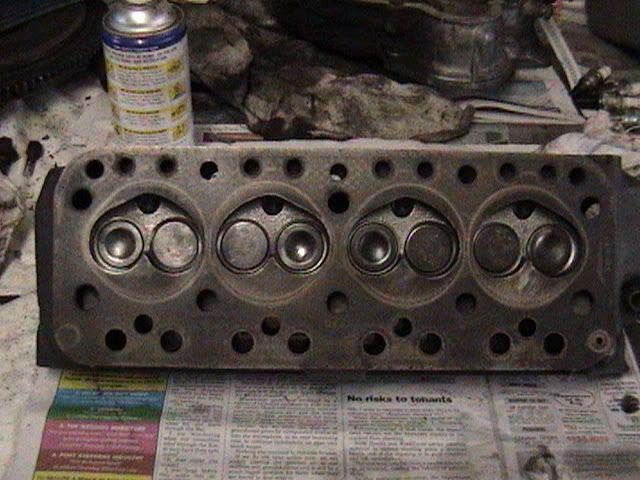

I did a bit of cleaning up of the head today.
Before
After
Slowly getting there. Hopefully the new gasket set will be here tomorrow.

Most of us who have been around motors for a while can tell you that you have a couple of problems with that head and the valves. The very last photo shows a valve sitting very unevenly in the valve seat and its probably because of badly worn valve guides.
In other photos several of the valves are sitting very low in the seats and should be replaced because the valve seal angle has so little metal left that it will soon burn through.
my last comment may cause some comment but the head in general is typical of what I have come to see when the user is using unleaded petrol without an additive. That is; Heavy carbon build up, noticable valve recission etc.
I am not trying to be clever or nasty but I do think this head needs a full machine shop service
Doc - whats your opinion. ????

Thanks Mike. I used a small wire brush in the drill to clean it up and thought it had come up alright but I didn't know about what you just mentioned.
I'll have a look at the head that comes off the current engine this weekend and see if things look a little better on it. I thought there was a bit too much crap built up on it :(
Ziff

If the exhaust valves have sunk into the head it's a good time for a set of unleaded seats to be fitted, along with 4 new exhaust valves and a set of guides... :wink:

Spending the money on the head will not be wasted. It (the reco'ed head) will go onto your 850 when you are ready. But yes you can just bolt this head you have cleaned up onto a temporary motor and you can drive it.
It does have problems and you are now aware of them. Mini motors are tough and when it is all said and done and you are not contemplating 163 laps of Mt Panorama.
