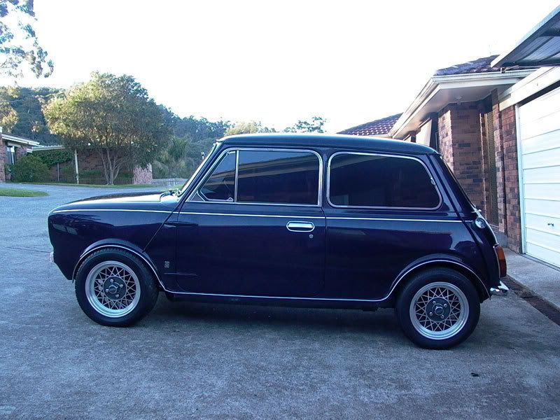

i have seen them on a few minis... eg.

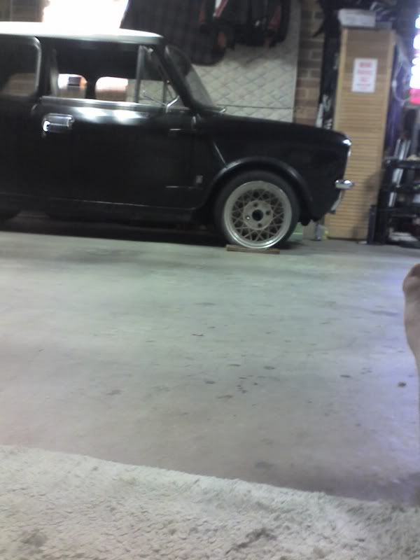

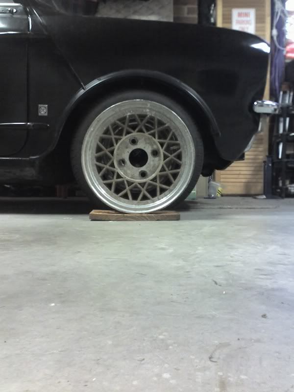

are they correct for a mini.... i know that my guards would need cutting if they are 13z, but is there any other things that say NO!

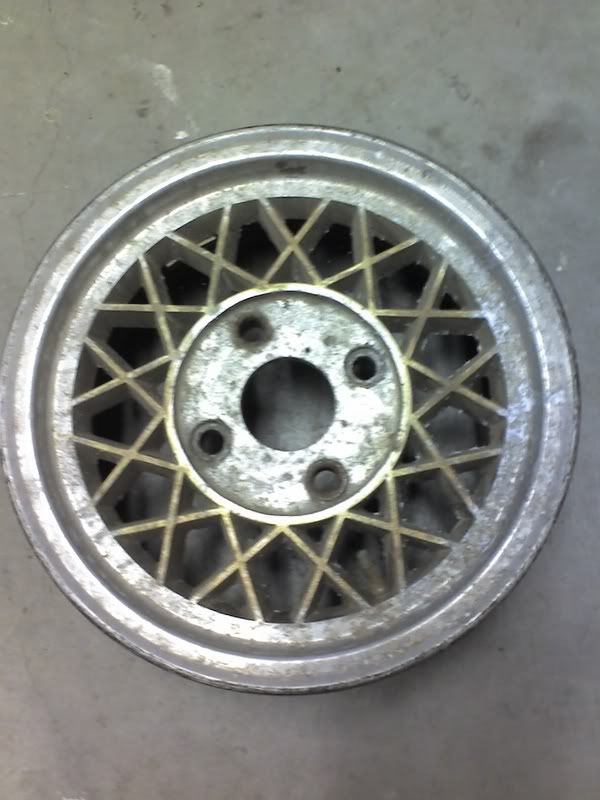

Tait , they should be 12" hotwire's of an unknown brand , they look identical to the ones I have on the Fang and several are running onmini's without modifications . Some went on ebay about a year ago for $150 in similar condition but only one person bid on them , how much were you offered them for ?

You'll need to use the mag wheel nuts that are the same as the jelly bean mags , they are a thicker diameter nut than the contesta ones . Also , the good Doc can turn up your missing washers in the stud holes .

check the spokes aren't cracked

they will not fit onto the mini.... :cry: :cry: :cry:
just tried to fit them on and the holes dont match up
PostPosted: Fri Feb 16, 2007 6:10 pm
Bugger , not 4 X 4" pcd then ?

Saw the same rims on an old honda civic at the wrecker.
They were either 4x100 or 4x114 something.
PostPosted: Fri Feb 16, 2007 6:35 pm
Posts: 5281
They are not just twelves. they also come in 13s and they dont fit minis. you need to get the stud holes modified, but i dont know how safe that is.
