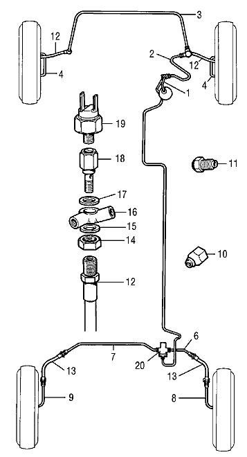

A saw tooth type washer under the big nut holding the flex brake hose to the front sub frame that is.
The parts manual I have only shows the left side and there is one there but the MiniMania online cattledog only shows the right side with the brake light switch and doesn't have it.

I believe there should be 1 each side... :wink:

Docs right again. My parts list shows the shake proof washer or, as you call it 'saw tooth', on both sides.

Its purpose is to ensure the hoses don't move, twist, and get rubbed by the tiebars.
This is even more important now that many Mini places here only carry the drum brake hoses, not the disc ones (which are slightly shorter).
So you need to twist these a little if used with disc brakes, so they miss. :wink:

Wombat, what do the numbers on each brake pipe in the diagram correspond to?

The line in the catalogue list which was under the drawing
http://www.minimania.com/web/CatPage/9-13/Chapter/9/Page/13/MiniCooperCatalog.cfm

Chasing around for the shakeproof star washers - no one has them 5/8" ID not Supercrap or Repco - MM have them for like $4 each and MS have something that sounds like it (no size mentioned) for $2
Finally found a small parts and accessories outlet near home - massive price of 15c each :shock:
