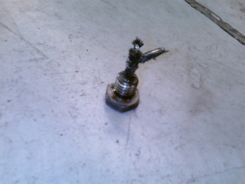

well today was a long day, had uni this mornin and then spent 4.5hrs pulling bits and pieces off my engine in order to pull the engine out on thursday. so far however, when draining the oil this was sticking to the magnet on the sump plug :shock:
looks to me like a tooth off a gear, not to mention all the other fragments on the magnet.

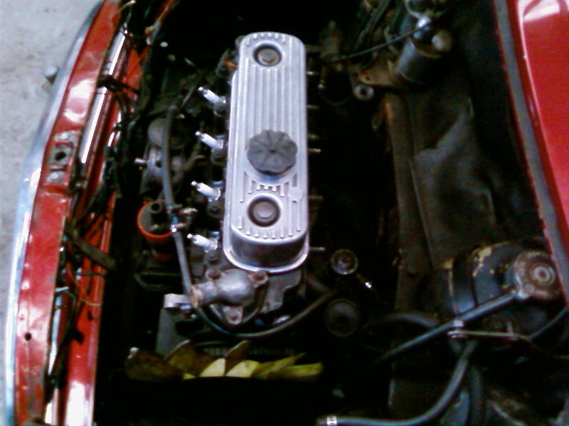

here is the engine ready to be pulled out
now is the eager wait for thursday to see the damage :cry:

PostPosted: Tue Apr 24, 2007 7:27 pm
Posts: 39757
I reckon you've stripped 2nd gear, and/or the cluster gear..
I'd make sure the rest of the box is all good when you rebuild it.
I did up an S box for a certain person on this forum, had same problem- and it was missing the needle roller bearing off the mainshaft nose! :shock:
