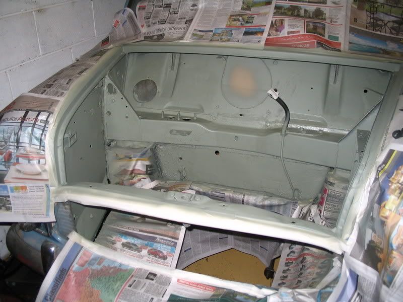

During with etch primer:

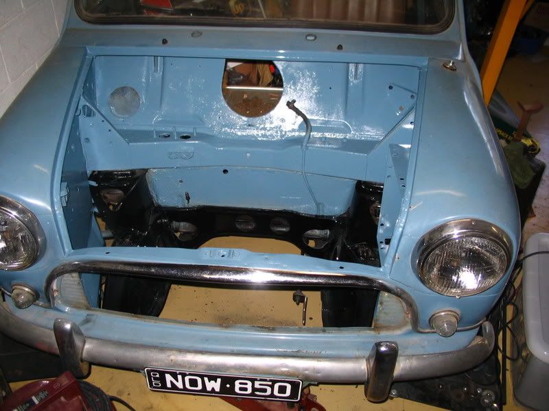

Finished - Used enamel:

a thousand times better mate. great work!

Scrubbed up really well.
PostPosted: Sat Mar 03, 2007 3:18 pm
Posts: 11749
Excellent. Dont you big returns for simple things. Looks great

that makes a lot of difference.

nice job thank you it helps me alot

looks very good champ

Looks hot!

Day to strip out the loom,brake lines and anything else removeable and start cleaning treating rust etc. couple of hours on two separate days to hand paint Por15 on the subframe. Half a day to mask up and give 2-3 coats of primer. Then it sat for about a month or so while I found someone that would supply auto enamel in a pressure pack can and me to get the time to drive an hour each way to get it :roll: Couple of hours to give it two coats and another touch up after I took the photo and could see the bits I missed :wink:

You masked up VERY well! Nice job.

that looks great! i gotta do that eventually..... :D
