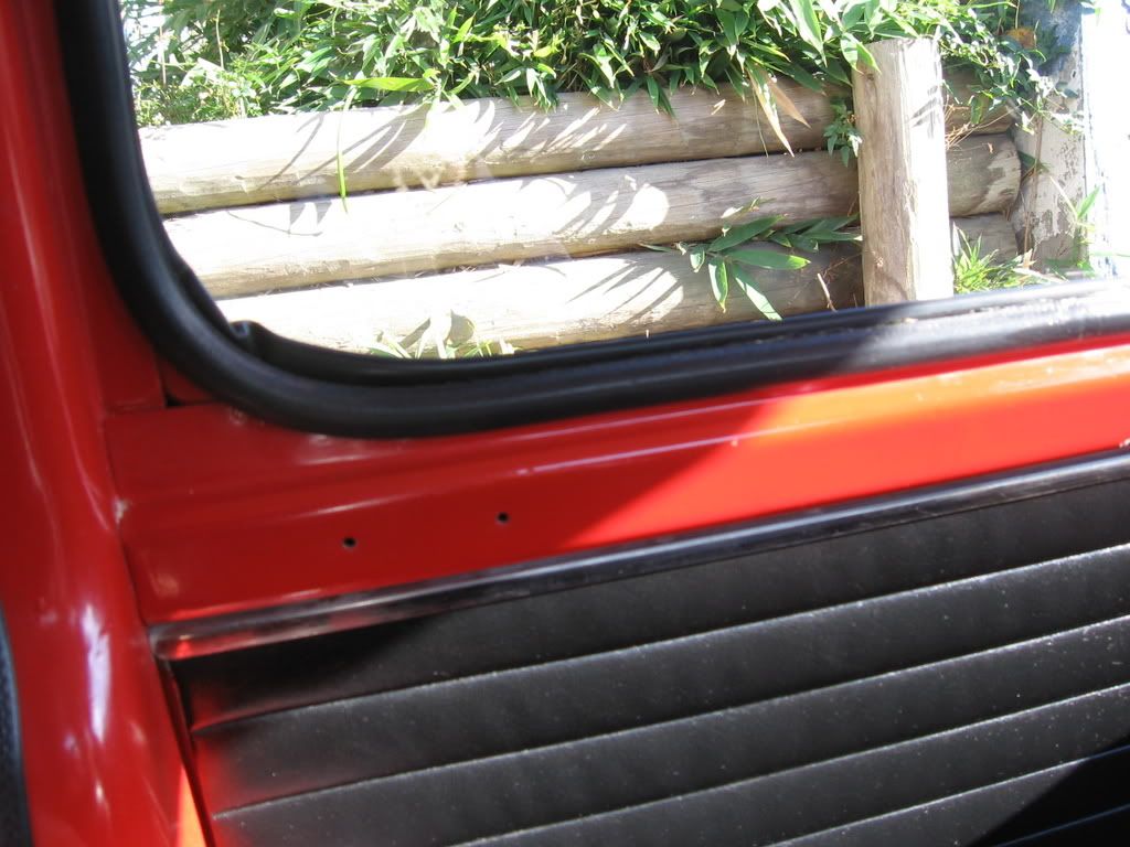

Hi all - here are a couple of pics of the interior of my Cooper S, just behind the B pillars, left and right, just under the side windows. As you can see there are 2 holes on each side, symetrical and only about 1 to 2mm diameter - they appear to maybe have had screws in them.
What do you think these holes were used for? They seem too small for seat belt mounts or roll cage bolts. Got me stumped.
Interested in your thoughts.....

They are for the original seat belt clips. They are white and come in an early and late type. The later ones were wider between the holes. All became brittle, and were fragile from the get go as you only have to reach around and reef the seat belt once to smash them.

The one above is the early clip, the holes are only 23 mm apart, and it hangs on the clip by the seat belt buckle.
the later one has holes 33mm apart (or whatever that is in imperial fractions, I'm not prepared to work out...), and has the belts slide in from behind just to keep it out of the door jam. The lower one is in two pieces, the white half was still attached to the car, while the dirty portion was down in the bottom of the rear bin. An obvious fate for many of the clips. I would reccomend digging around in there to try and find them, you might just get lucky.

Awesome - thanks Mick, that explains it! And thanks for the pics too.
