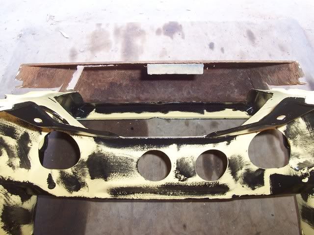

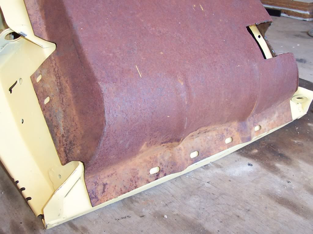

I'm pretty sure this is a Moke sump guard and I want to fit it to a mini subframe. Is their a difference between the two subframes (Moke-mini)? because it doesn't seem to line up fully :? The front is good but from the rear (2nd pic) their is an inch gap along each side.
I think it will still fit fine but what do yous think :?:

pfft, attach it at the front, then put the jack under it.... it'll fit properly quickly enough
you don't live in a warm climate do you??

Theirs actually no bolt holes in the rear section only in the front and side wings which all fit perfectly :D and yes it is warm up here in QLD but I have a thermo fan for security :wink: .

Then put bolt holes in the rear section because one day your going to catch it in reverse and do a lot of damage. Apart from that its likely to flap underneath - sound annoying and eventually fatigue crack either the sub frame and the sump guard mounts.

Yep I would drill holes in the subby up the back so it would not catch when reversing :?

Kenno,,, if you fit that moke sump guard to a mini then you will be hitting just about every bump in the road with it,,, they are WAY too low for the average mini
just grab a decent "mini" one

Yes , they don't fit as snuggly to the gearbox as the nice mini ones do , probably sit about an inch lower than a bare sump and all those things that you just got over you now don't ....
