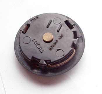

I got my new repro horn from the UK today....still not sure how to fit it though. One of the guys at work mentioned i'm missing a spring, does anyone have a pic of their setup?
Will i still need the horn wire with the new setup? It have the newer style wheel on it. Now i've changed it back the original with the M in the center.
Cheers.

Im waiting on a reply to this as well, hopefully Doogie can post that pic :wink:
Im pretty sure all that is missing is something to earth the horn, maybe a spring that connects the centre brass piece of the horn switch to the nut on the column?
Or mabe a strip of metal from the nut to the side of the horn switch, as the earlier versions have part of the internal spring of the switch sticking out the side (this also helps to keep the horn switch in)

we are thinking its a tapered spring, if you look at the pic with the steering wheel there is a wear mark, so maybe the spring goes from there to the button? really in the dark on this one, don't know of any roundy's is townsville to check with.

Hold onto your hats people, I might provide information of use for once here. :D
I have two setups here, both used the original horn push in different ways.
The bus twirler has a long clear plastic bush with a spring. A circlip holds a bullet connector on the top. When the horn button is pushed, the outer part earths on the steering wheel nut I believe.
Assembled:
Apart (sort of):
In my other setup, the spring is not used, and the spacer bust has been shortened to a 1/3 length. When the horn button is pushed, it is this one that contacts, not the other side.
Assembled:
Apart:

You may find the new repro one may need something different as well as it isnt the same as the original on the bottom....im trying to work out where the positive wire connects to and if there is supposed to be another spring underneath?
Edit....
Ahh cheers Harley, well that definately sorts mine out....it will be the top setup you posted...now just to find one of these spring pieces :wink:
