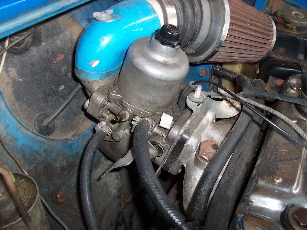

Bit embarrassed to be asking this but exactly what type of carbie is this. It came on a 1990 Rover Cooper 1275. I know it's 1" 3/4.

That would be a HIF44.

Ill second its a Hif44 which I also run on a 1100 8)

ill 2nd that 2nd with a hif44 im running one atm on tiny's warm 1100

looks like the pod filter needs a clean.

Yep definitely a HIF 44

Looks like a HIF44. :wink:
The 44 refers to the metric size of 44mm. They were originaly called HIF-6 using the old SU imperial system.
The system used the number of 1/8ths of an inch above an inch.
So the 6 = 6/8ths which equals 3/4.
So you add 1 inch to it and you get 1 3/4"

fully sick filter and yeah second a new pod filter.
