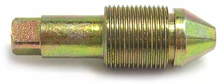

Yer no point adjusting drums with wheels off.
Jack each end up so the wheels rotate. you will find they will be spinning freely. With the adjustment of drums you have a pyramid style on the end of the adjuster. You are looking for the shoes to be slightly rubbing when you can feel its on the flatter section and not the corners of the adjuster

Posts: 441
That picture is true only for the rear drums. The fronts use a completely different system which is a cam type and there is one adjuster per shoe so 4 total for the front. That is 6 total adjusters per car.
PostPosted: Sun Aug 24, 2008 3:35 pm
shows its been a very long time since I played with front drums then :lol:
