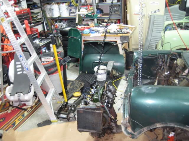

Here's a couple of pictures.
First one might show the lifting bracket--I wanted a bit thicker steel, but there is no indication of bowing/stretching/tearing/etc. Took all of 15 minutes to make it.
Second one shows that I'm running out of garage space and starting to get cluttered. I need to pause and organize/put away tools/throw out old stuff/consider my plan.
