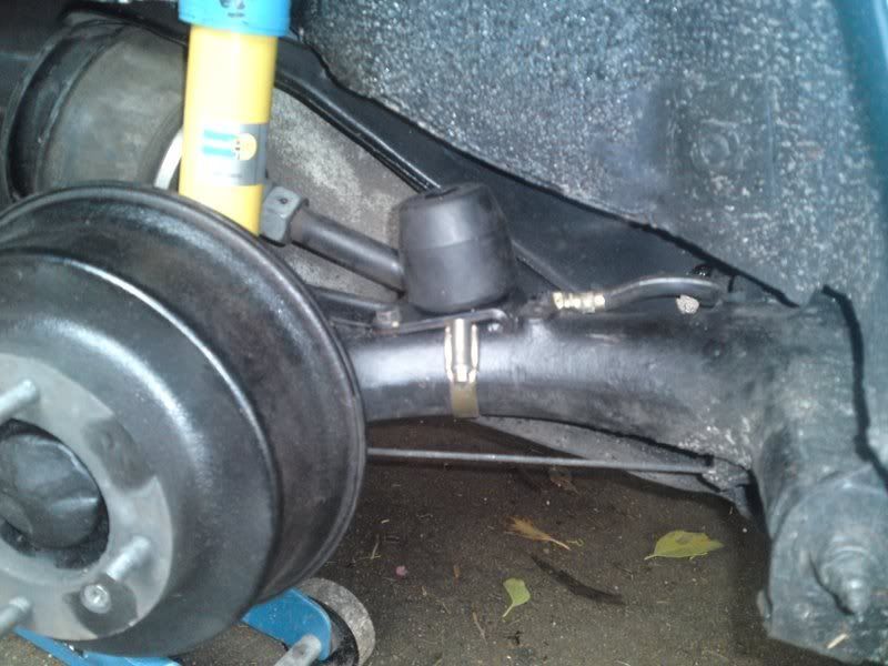

Kev and I fitted them to my car over the long weekend and what can i say..turn in is substantially improved as is body roll and weight transfer to the rear. Very impressive.
Installed on a Dry car, so had to drill and tap the rear trailing arms and move the brake line.

finally someone has provided me a picture of where the bloody things go. Thanks mate.
Did you have problems with the tyres rubbing on the arches when loaded up prior to fitting them?
BTW Vizard reckons you should tie the brake pipe down in its new position with a hose clamp around the arm. Did you do this as well?
cheers
michael
PostPosted: Thu Oct 09, 2008 5:46 am
Posts: 39755

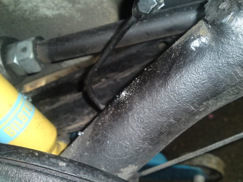

In that pic the new bolt (5/16 UNF) hasn't been tightened yet.
Note both arms were FULL of grease! :shock:
Yes I did put a hoseclamp round the pipe, under the new brackets.
You just need to bend the body flange out about 45° with vicegrips so it doesn't cut the rubber.
IMO they not only reduce rear squat when accelerating, they add roll stiffness, similar to what a rear sway bar does, so turn-in is improved.
They transformed my hydro's handling when fitted years ago. :D

PostPosted: Thu Oct 09, 2008 8:28 am
cheers
michael
No issues with rubbing, it's got hi-lo's in the rear as well but I just wanted to minimise the pitching to the rear when i plant it and Kev told me of the added benefit of better turn in and he's right, they are a massive change for minimal outlay. If anything they do make the car twitchy but i'm liking iit 8)
As Kev said the brake pipe is tied down with a hose clamp, here's a pic:
