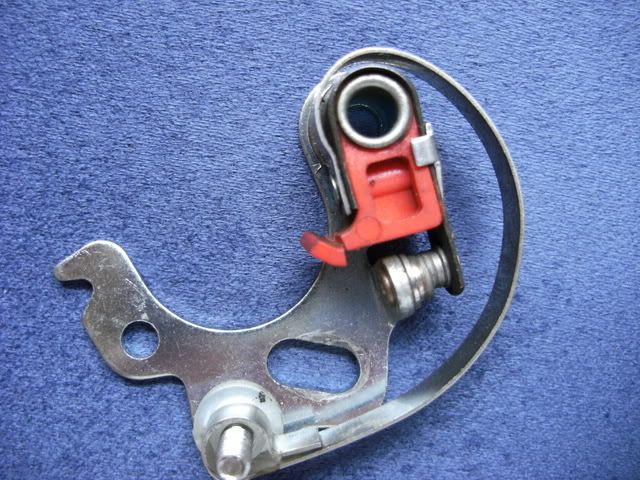

finally got around to putting the battery back in the car on thursday. still woudnt turn over though. but it sounded stronger. so, i got my mate to turn the key while i held the spark plug next to the head stud. no spark. righto.
i took the dizzy cap off and straight away saw the culprit...
changed the points, put it all back together. my mate says to me "are you excited?" i said "not really, i dont want to be disappointed" but i turned it over and it fired up!!! i got so excited!!! took it for a blockey, it was very noisy, and the brakes were crap.
