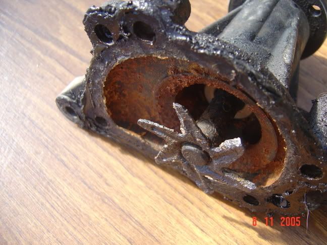

try a water pump that doesn't look like this :wink: :wink:

yer thats pretty much my old one
